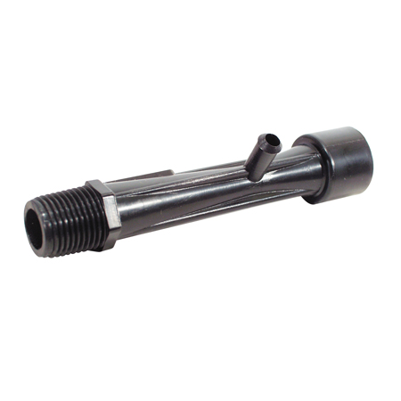

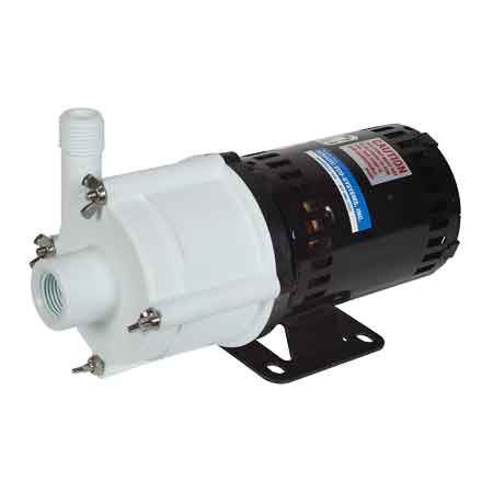

Contact the mermaid marine factory. They can design and build you a complete package. Just do not use there little red pump. Do a few minor upgrades. Get a proper raw water pump. Such as a little giant. Do the venturi to suck the concendation from pan but do not get theirs. See pics below.

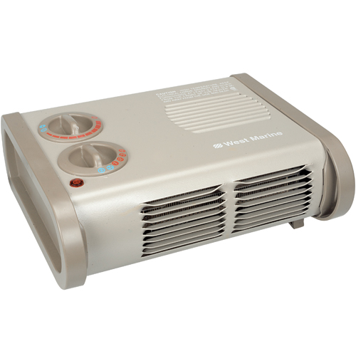

I do not use the heat function any more. I found for winter a couple of low profile marine cabin heaters from west marine work much better.
