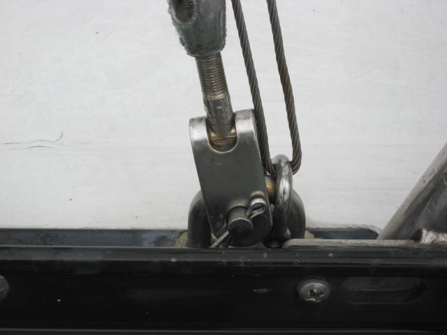

Are these the u-bolts you are referring to? If so, I better do the change out. I presume that this can be done with the mast still up? I could utilize my topping lift which is SS wire affixed to the mast head as a temporary back stay when the u-bolts are changed out.

Rardi, yes those are the U-Bolts. I purchased mine from Marine Max. They are a power boat store but I find a lot of good prices there. There seems to be one in Emeryville out where you live. When taking the Bimini off, doing one side of the split back-stay at a time keeps the mast up. Of course another line, even the main halyard tied to the stern gives you peace of mind.

Mike, Ed, the ones you showed us are more money than they have to be. Also the Wichard ones are metric; and I don't like the rubber boot because it is solid and does now allow you to get the 5200 right into the tops of the bolt holes to stop leaks. I prefer to take that thing right off and use locknuts against bright SS fender washers as trim rings on the deck. Looks better too.
