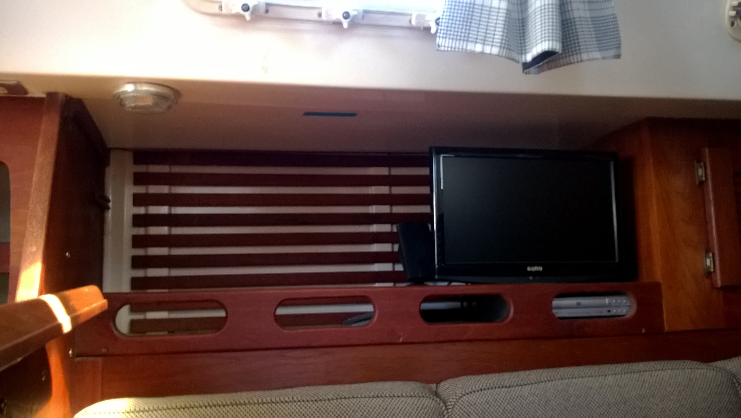

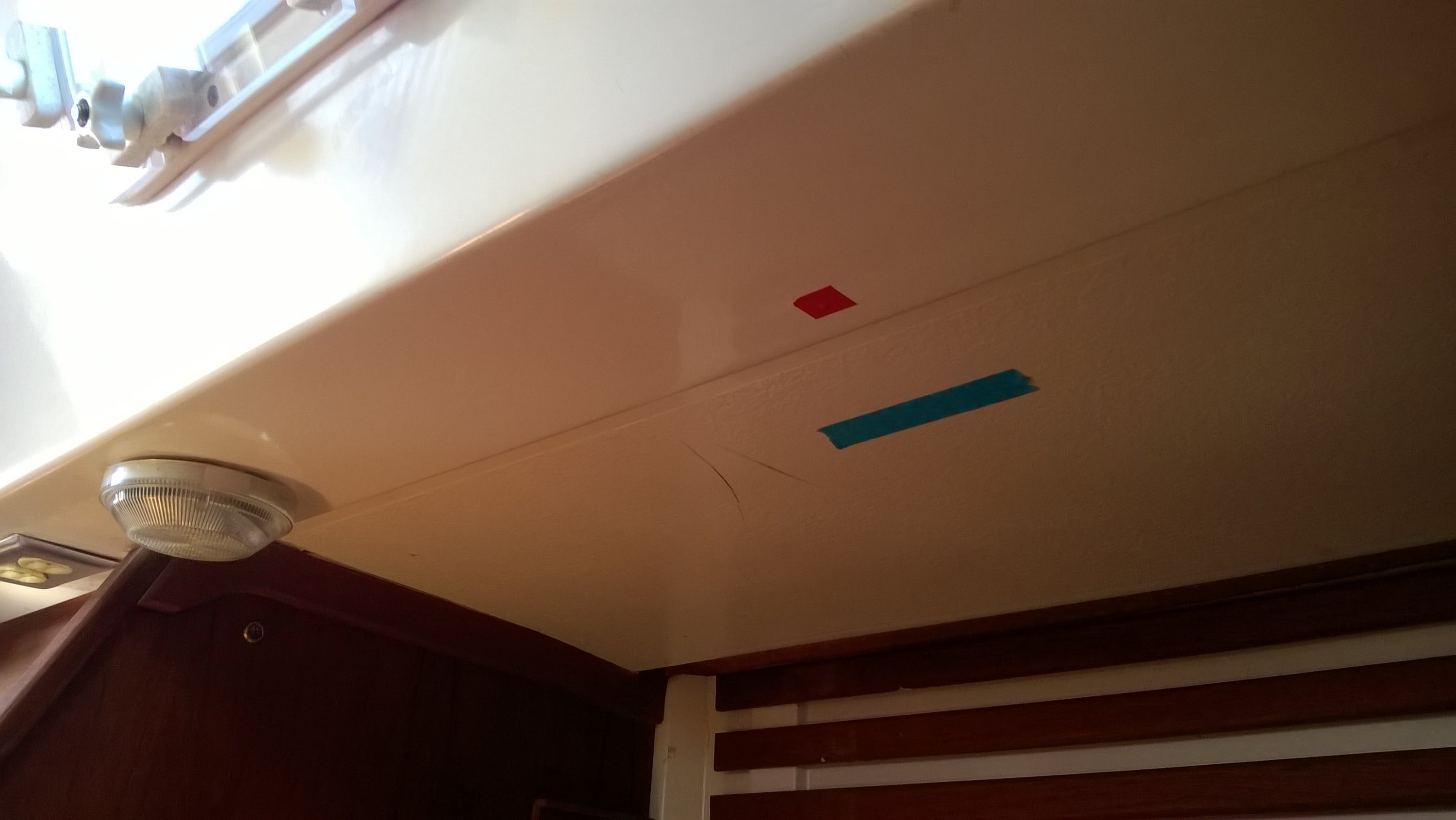

I have posted some pictures of the interior liner near the gunwale so any interested respondents can get a feeling of my boat's layout. The blue tape is where I would need to mount for a full plywood core location. Too close to the toe rail to be much of an improvement. The red tape is through the deck's single layer of FRP near the cabin top.
I would cut a 5 feet by 2" rectangular slot in the liner so that I could insert the IPE piece. The liner at this location does not seem to be anything "structural" to the boat.
