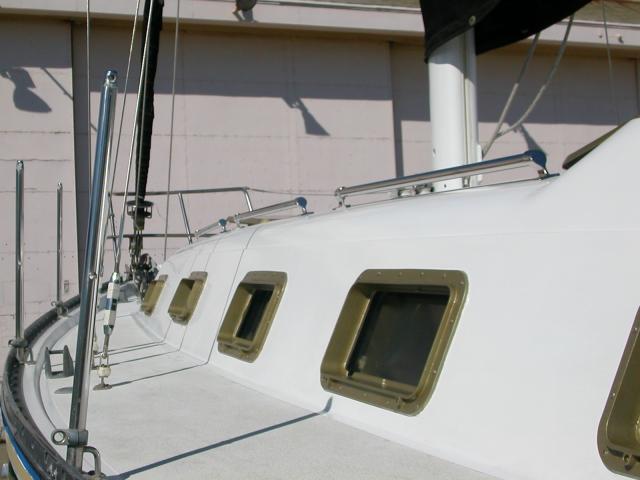

My 1980 Cherubini Hunter 36 doesn't fair as well close hauled as well as most other cruising boats on SF Bay. Striking out from Sausalito at about the same time, other boats can be as much as 1/4 - 1/3 mile further upwind than me over the ~2.5 mile run towards Crissy Field on the San Francisco side.
The existing jib fairlead system is snap shackle blocks on the toe rail. How much better pointing can be acheived with an inside fairlead track? A problem I have is that the shrouds meet the deck close to the toe rail rather than near the cabin top. (See picture.) If I did have an inside track, and the sheet is led outside of the shrouds, the sheet and sail (if > that a 100% Genoa) wouldn't be able to pull straight to the block without bending/shaffing against the shroud. If the sheet is led inside the shrouds, then the sheet and/or the jib would billow out against the shroud, particularly when easing out the jib for (say) beam reaching. Does anyone know of a solution for boats with outside shrouds?

Sometimes the question comes up as to why does one need inside and/or outside tracks? The reason is simple and also why generally serious racers have both. You use the inside track when closehauled and the outside track for all other points of sail.
Next question is why do some boat buiders put the tracks next to the cabin and others put them on the rail? There is no reason other than they have to put them somewhere. In your case, since you don't have a track but may be considering getting one then your best choice might be right down the middle. You get a little bit of both worlds.
Personally, I don't think the system you have is very efficient. It is hard to change the fairlead position under load and chances are you won't move it. If you have a masthead rig your wasting a lot of power from your jib but on the other hand a 90 does not generate a lot of power anyway.
