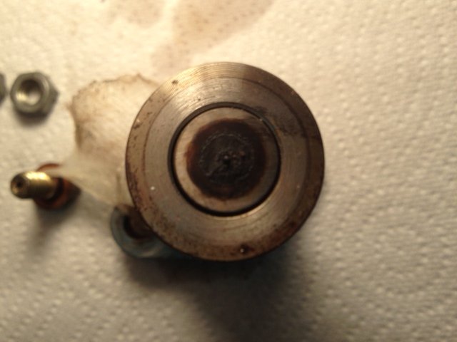

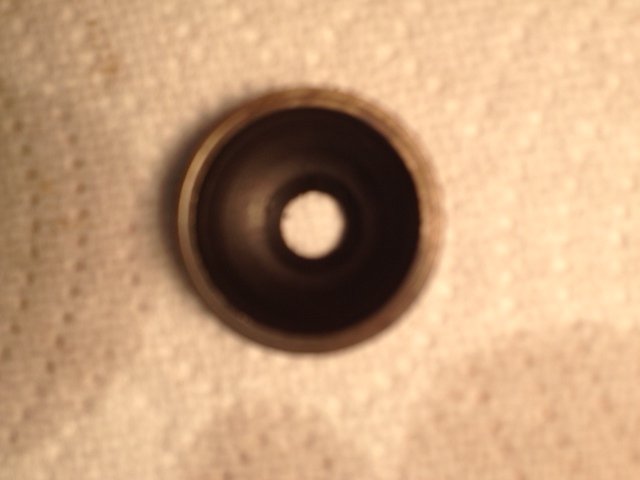

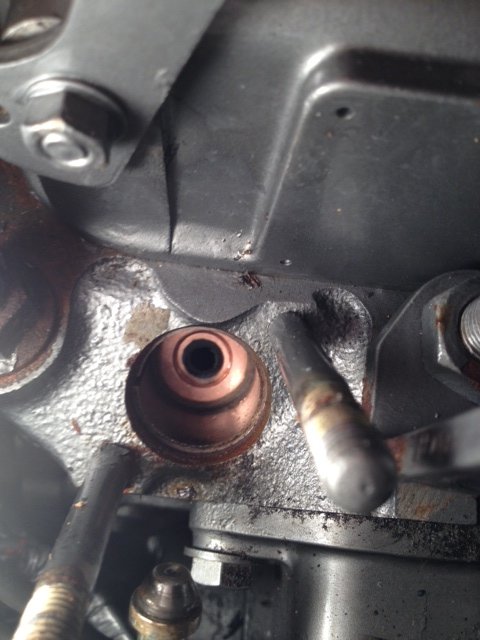

Hi Guys,
Getting ready for the next season.
I'm replacing the injectors on my 1983 Yarnmar 2GM. I've got the old injector out and the uppor part of the conbustion chamber removed. The pics below show the bottom of the removed injector, the engine with the injecto removed and the top of the chamber still in place. (It came right out). I also include a pic of the inside of the top part of the injection chamber. I don't know how to get the bottom part of the combstion chamber and the ttwo copper washers out.
Any advice would be much appreciated...

Spray some WD40, let it soak then bend a small hook on steel wire to pull out the pieces. I think it may work.

Like Ken says, a little WD or some PB blaster .. let it sit a day or so.. Be careful not to scratch the washer seat in the head.

I guess that makes sense. The previous owner of my boat allowed the vented loop to drip salt water on the head of my 3GM30 for years, leaving it an ugly rusty mess, so if/when I do tackle this job, I'm also planning to replace the injector mounting studs and retainers, along with all the fuel lines and brackets. I'm expecting the injectors to be corrosion-welded into the head, which is one reason I haven't tried to remove them yet.
I read on another thread that a good way to get those lower pieces out of the injector bores is to run an appropriately sized tap from your tap and die set down through them. You might consider that if you can't extract them with a pick. My only concern would be the possibility of creating metal cuttings that could drop down into the cylinders.
