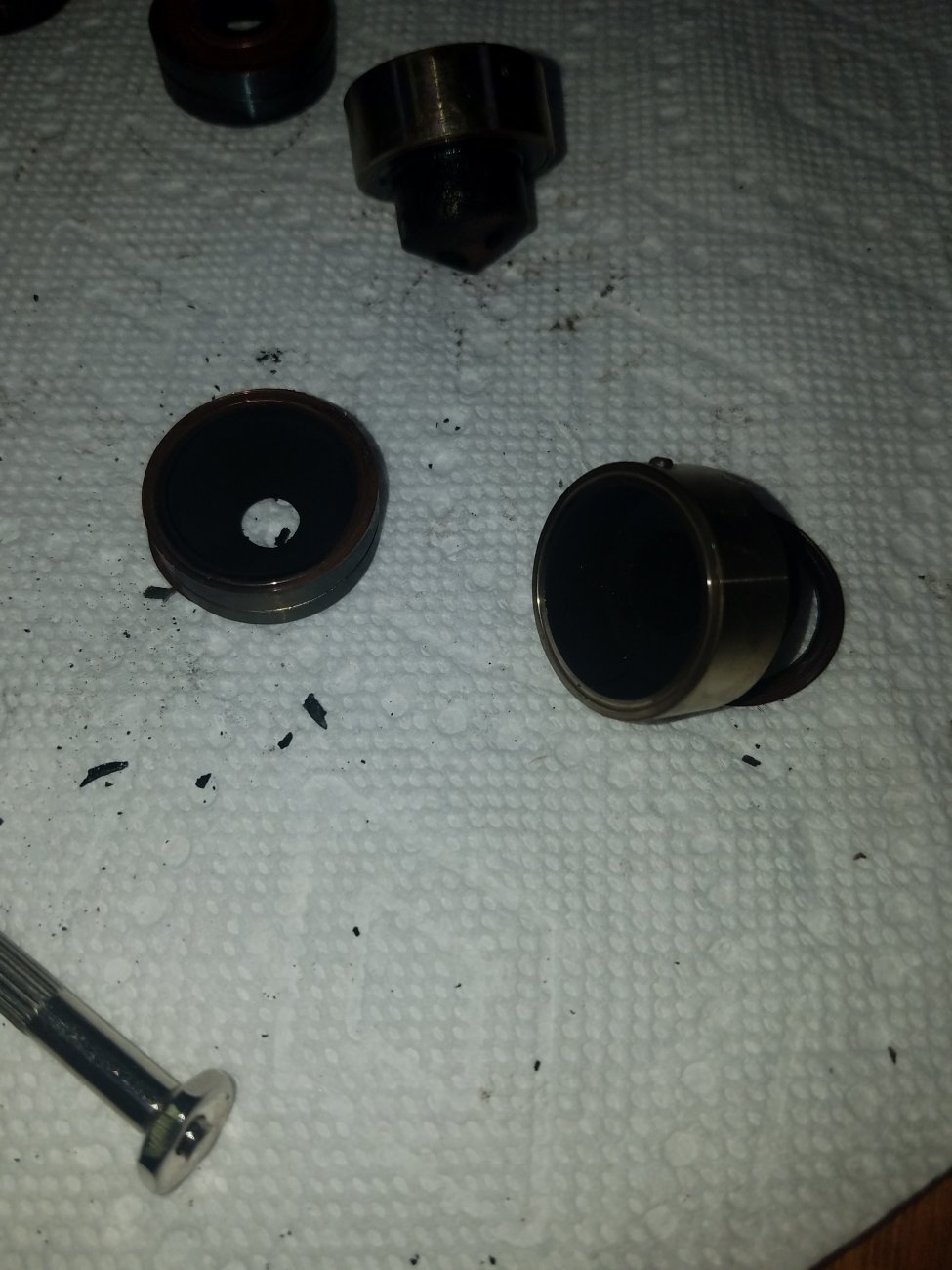

Well, I spoke too soon. I went back to the boat and was able to slide the front and rear chambers out Looks like I need to only replace the copper washers, insulator and O ring for each and clean the chambers.

The order is - from bottom to top - copper seal, pre-combustion chamber, copper seal, insulator, seal,cover, injector with O-ring. The O-ring keeps the the moisture out of the injector bore - see to it you use new ones in each bore. See shop Manual 2-11.

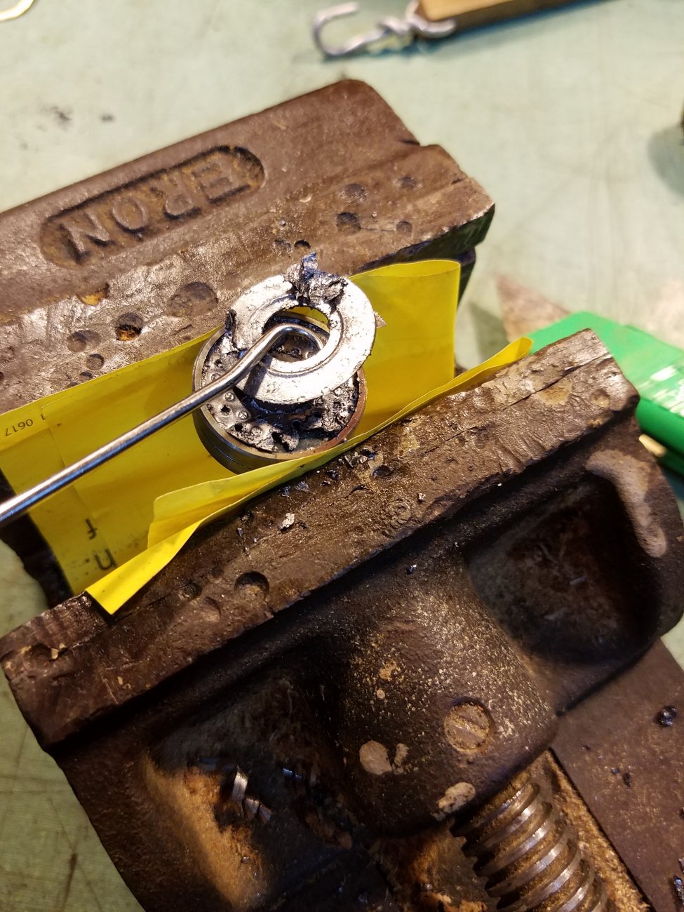

Tim's experience is unusual. Unlikely you will be able to get the first two (seal and pre-combustion chamber) out of the bore. If you do you are very lucky indeed. As to the next in the stack - seal, insulator, and the insulator seal and cover - be aware the last two (the insulator, insulator seal, and cover) will look like one thing because they are well smashed together.
The short of it is - do not expect the very bottom items (copper seal and the pre-cumbustion chamber) can be removed - unless you remove the head and press these chambers out from the piston side.
So replace what you can remove. In any case the insulator and the pre-cumbustion chamber are the only things you will reuse. The rest need be replaced with new (costs pennies by the way.)
When installing the parts use Antiseize Nickel to coat the parts - far better than copper or aluminum versions in this particular case.
14 ft/lbs evenly on the injector hold down retainer nuts - no more.
All three bores get the same treatment.

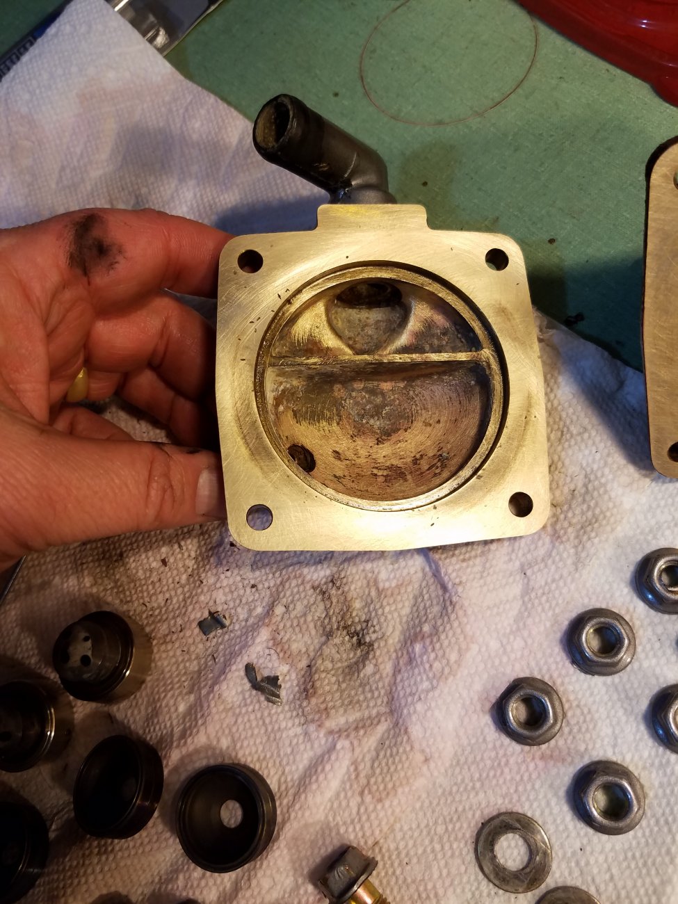

You are correct. The seals and insulator parts are all mashed together and it was difficult to even tell they are separate parts.20190310_163129.jpg 20190318_194520.jpg 20190318_194015.jpg 20190318_215036.jpg

Since you are in the region - consider replacement of the goose neck (mixing elbow) in photo #1. Here is a lead. I have used these - and they are quite reliable.
https://hdimarine.net/product-category/yanmar/
In any case a clean mixing elbow (factory or HDI) is the objective. The problem is that most folks don't make an honest analysis of a degraded (strangled) mixing elbow.
Otherwise your reinstall looks spiffy - and that is worth plenty in my estimate.

I have already ordered a stainless steel mixing elbow and exhaust manifold.

I had a diesel shop recondition the injectors. They were tested and all failed pop tests. They have been reconditioned with new nozzles for $100 ea. I have also had the cooler boiled out, cleaned and tested to 20psi for $125. New stainless mixing elbow and exhaust manifold is another $300. The old mixing elbow was at least 1/2 blocked. Getting a new thermostat and fuel lift pump while I'm at it. I'm doing all this for the same reason as well. I want to do the ARC Delmarva rally next year and don't want to worry about having any engine issues when off shore. Cooler cover and elbow pics attached.
