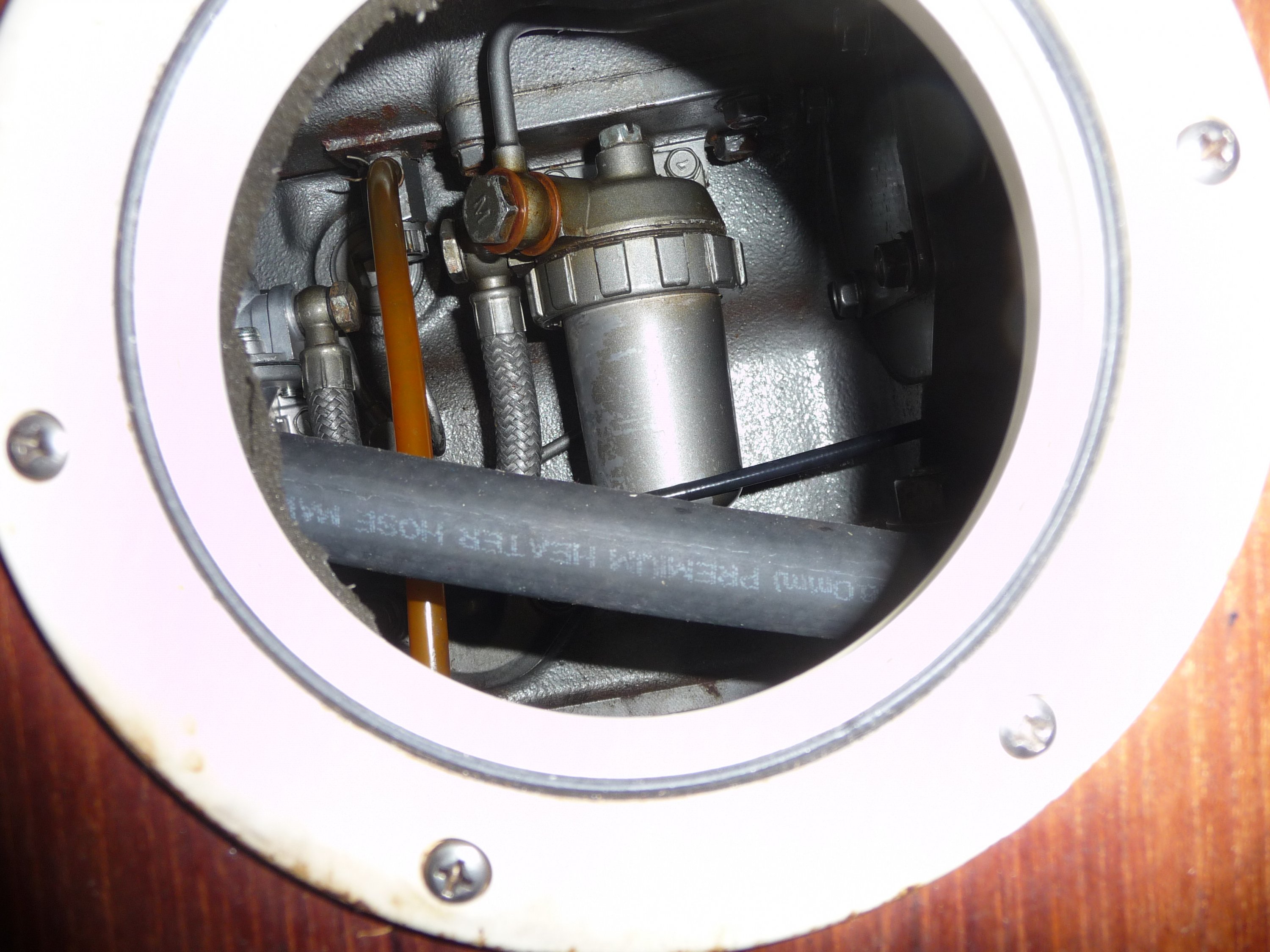

P1030176.JPG Yup, a few of us H-34 folks have changed our "lift" pumps.. That is what it is called in the shop manual.. a low pressure pump that "lifts" the fuel from the tank and feeds it to the high pressure injection pump.. It is held in by two bolts .. it has banjo connections on it so get some new copper washers before starting to change it.. Access to it is terrible .. ya end up with one hand from the front of the engine box and the other hand through the access hole for the secondary filter.. Attached picture shows the filter housing.. the pump is to the left of that.. you can see the outlet fitting and hose to the filter.. Before changing, get a 90 degree screw driver and tighten the top lid screws (without stripping them) .. you could have a very small air leak anywhere from the tank to the suction side of the lift pump.. or you could have some trash obstructing the in-tank tip of the fuel pick-up tube..

Monday I removed a squeeze bulb I had installed in-line to assist with filter changes with no improvement. I replaced the lift pump a couple years ago since the old one was leaking fuel into the bilge. I will be looking for an air leak, but think trash at the intake is likely.
