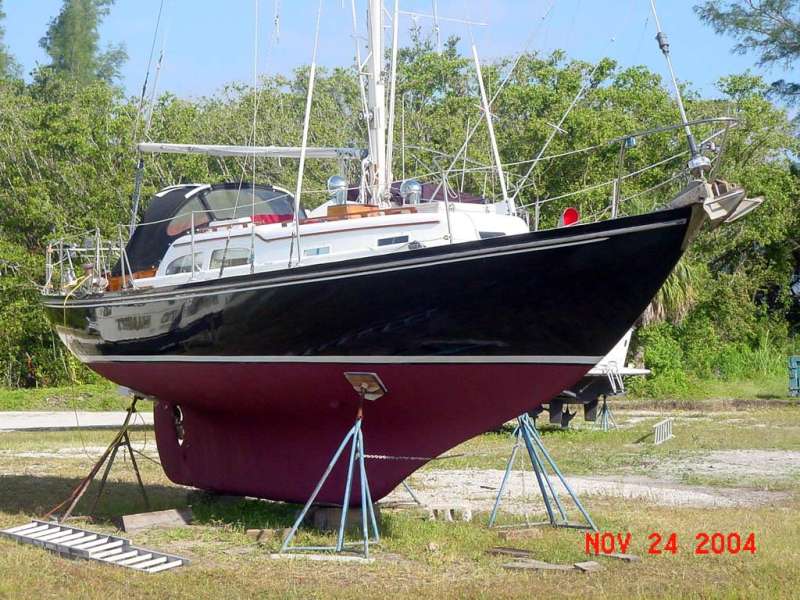

HI- thanks for the pictures. What a tremendous job. The cockpit redo looks great and the fixed glass in the doghouse looks fine with the wood trim removed. Boy, those wood trim pieces were fragile and leaky.
I remember, though I haven't found the documentation, that some of the finish work on Orca was done by Field Aircraft Services. Where Chipmunk lived when I bought her was Saybrook Marine who is also listed as a finishing source. Stuart Woodman, a principal at Saybrook Maarine told me he crewed for Mr. Baker. BTW in those days, Saybrook Marine was one of the white glove boatyards you don't often find. When I first looked at soon to be Orca, she was stored indoors in a bay where you could eat off the floor and had a parachute dust cover. Her finish was like a mirror. Stored next to her was Charley Morgan's "Paper Tiger". This kid was impressed! The boat even had fitted canvas covers for the side decks. Well, back to researching. Thanks all for your help

Bud - you're correct about Field Aircraft finishing Orca and I hope you'll keep us posted on your modeling progress. If you require any particular detail photos let me know.
Rick

Beautiful boat Rick. The Zephyr design has a very nice over all scale.
