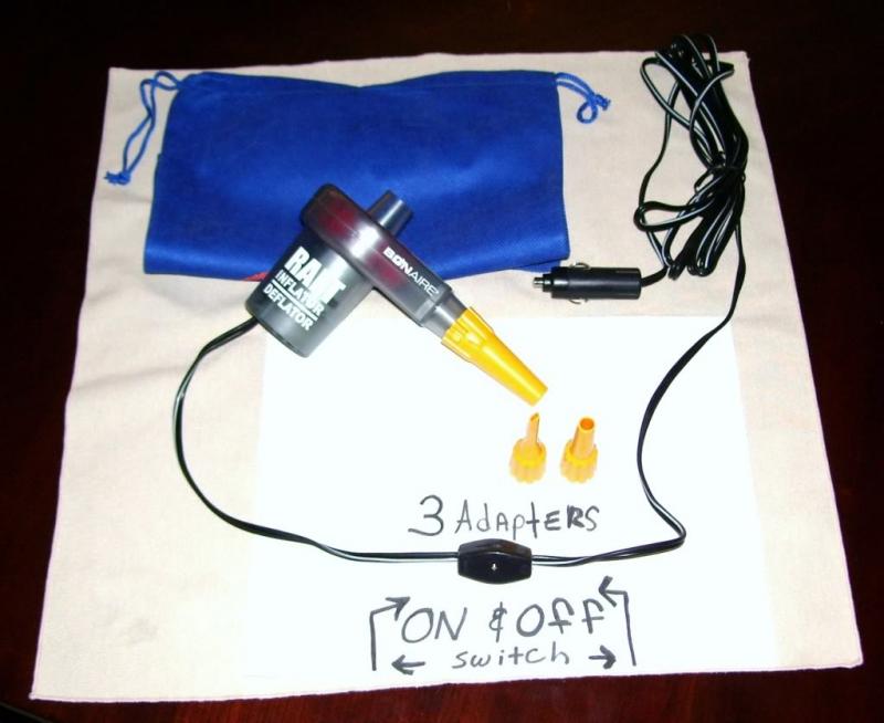

I've tried a couple 12v air pumps and the ones from China wouldn't pump air in a paper bag... the colman is OK but overpriced, but this one http://www.ebay.com/itm/Air-Pump-12...667?pt=LH_DefaultDomain_0&hash=item4ab4f008c3 seemed well made with a heavy 10' power cord and max air pressure to fill quickly and completely...Just holding it in your hand it has some weight (=magnets in motor)...
Doesn't look like much, but of the three I can guarentee it will fill your inflateable boat to readiness...

They are more a "turbine" fan rather than a compression pump, so they depend on volume and velocity of air movement to develop "pressure"...they need tight tolerances between fan and housing to prevent "stalling" airflow and a decent motor to keep fan speed up...

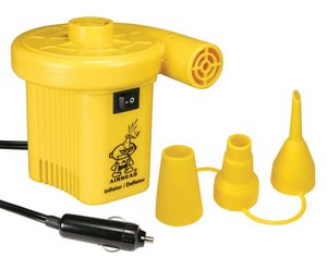

We have used one of these....
http://www.boatersland.com/kwkahp12h.html
...on the Zodiac for the past couple years. It says that it goes to .9 psi, but it seems a lot higher than that as I usually don't use the foot pump to top it off. I do normally use the foot pump every few days to add a little air. I've soaped the dinghy down and can't find a leak but it will require a few pumps every couple days.
The dinghy has a hard floor and not a high pressure one. We use the same pump on a couple blow-up beds we have. It puts out a lot of air and is quick and reversing it empties the dinghy very quickly and really compacts it in.
I have two extension cords I made from cheap hardware store outdoor ext. cord. One has clamps on the one end and we clamp it onto the Suburban's battery to fill the dinghy at the ramp with a female on the other. The other cord has a male 12 volt plug on one end and female on the other. It will plug into any of the 12 volt outlets we have on the boat.
