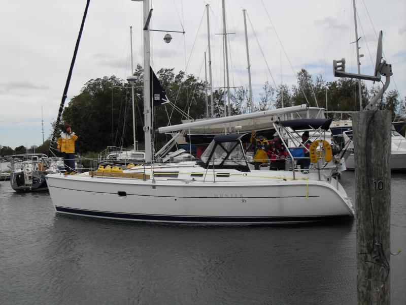

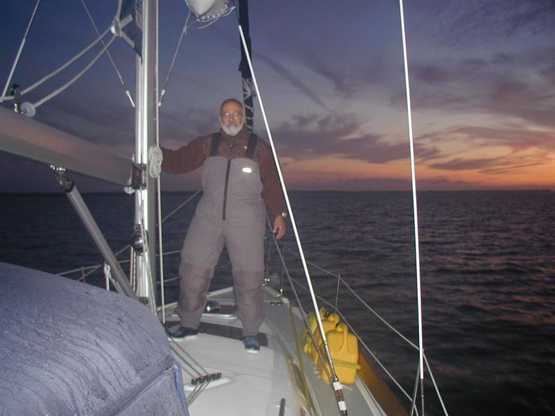

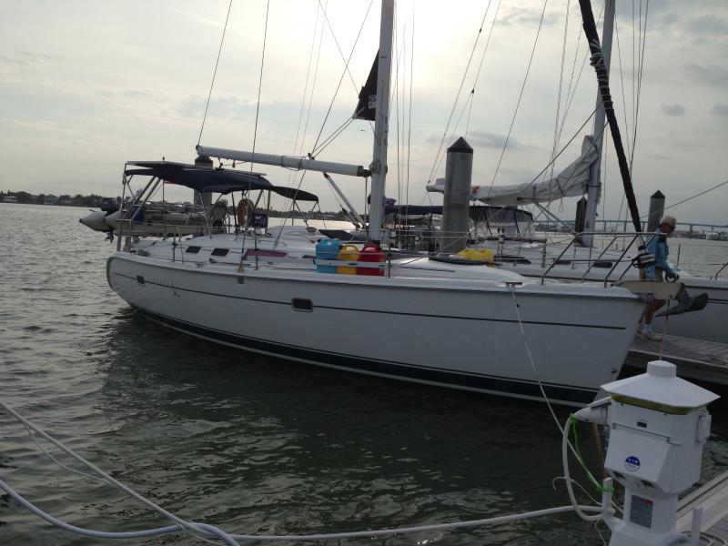

All the time
Very first time was from Montauk,NY to Florida almost all off shore
for 9 days and since i have 6 of them when ever I go cruising for 3 weeks
I use 4 of them and 2 -5 gallon water jugs also and jerry jug for ouboard gas.
Nick
