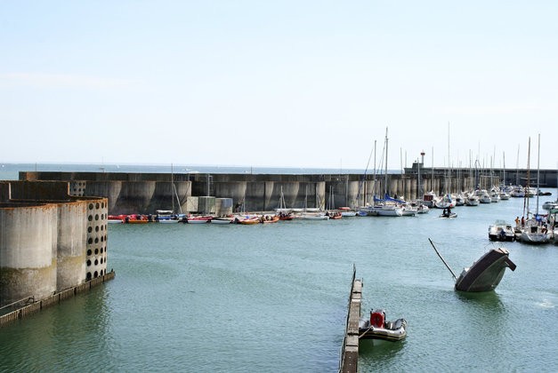

There were a couple of 25's and 26's made with diesels. But spending that much to modifiy a boat that old is questionable.
If you have experience in installing engines in boats and have old but good diesel to install, maybe.
But there are many good old boats with engines in them at reasonable prices. Even if you had to change engines, the boat is already set up for the internal.
On the 25 you would probably check oil from cockpit access hatch and climb down next to engine. Fuel tank probably could go in locker where out board fuel tank goes.
Structurally as already pointed out is the need for additional support be it stringers, motor mounting pilars, stongbacks, or more. And engine oil catch basin.
But properly installing an inboard in a boat that old? Major surgery.
I agree, look for a boat with a diesel in it or get a good outboard.

I bought an O'Day 25 last year that came with a small Yanmar 6.5 hp diesel and in the original brochure that it came with showed an inboard as an option. I haven't seen too many other diesel's on the 25, although I occasionally see them on the 26. It is nice not having to worry about the prop coming out of the water as a result of waves (Although an inboard would still have that problem in Ed's photo. Yikes!). I agree that unless you are really good at this stuff, this would be major surgery involving the electrical system as well as the motor installation. It might be better to just look for another boat. I saw some 26's with inboards listed on some other sites (the site had yacht in the title if I recall).
