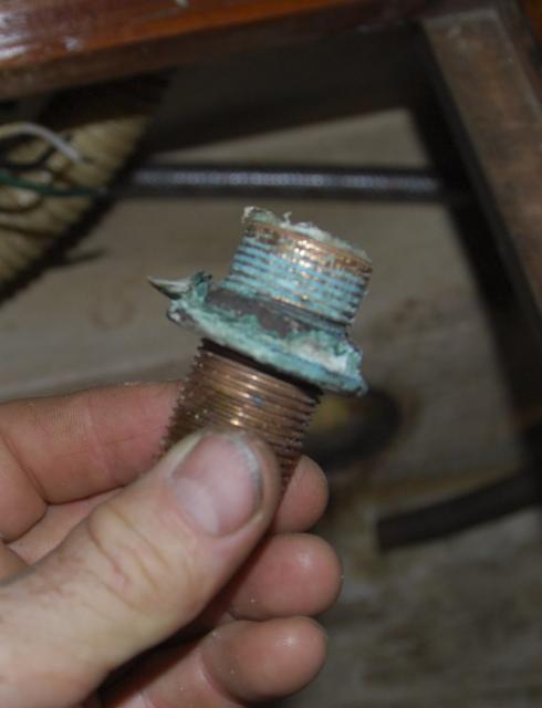

mine in my ericson was worst case scenario, redefined. i took her to municipal docks. a dive service told me estimate 1 day 2 guys. ended up 2 days 4 guys and perfect. was an original 1979 fitting with corrosion from years and mickey mouse repairs gone bad.. so done correctly now and perfect. is easy when there is a guy with a plunger handy.
