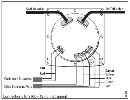

Just brainstorming:
My wind machine has 6 wires too, plus the shield.
It's an old Data Marine, but there's the possibility for similarity to yours here. It may be that 4 of the wires popped off, which would account for the device refusing to operate.
--check your Raymarine wiring diagram.
Edit: nevermind checking. I did it for you (pic).
Looks like the other wires go to the windvane.
