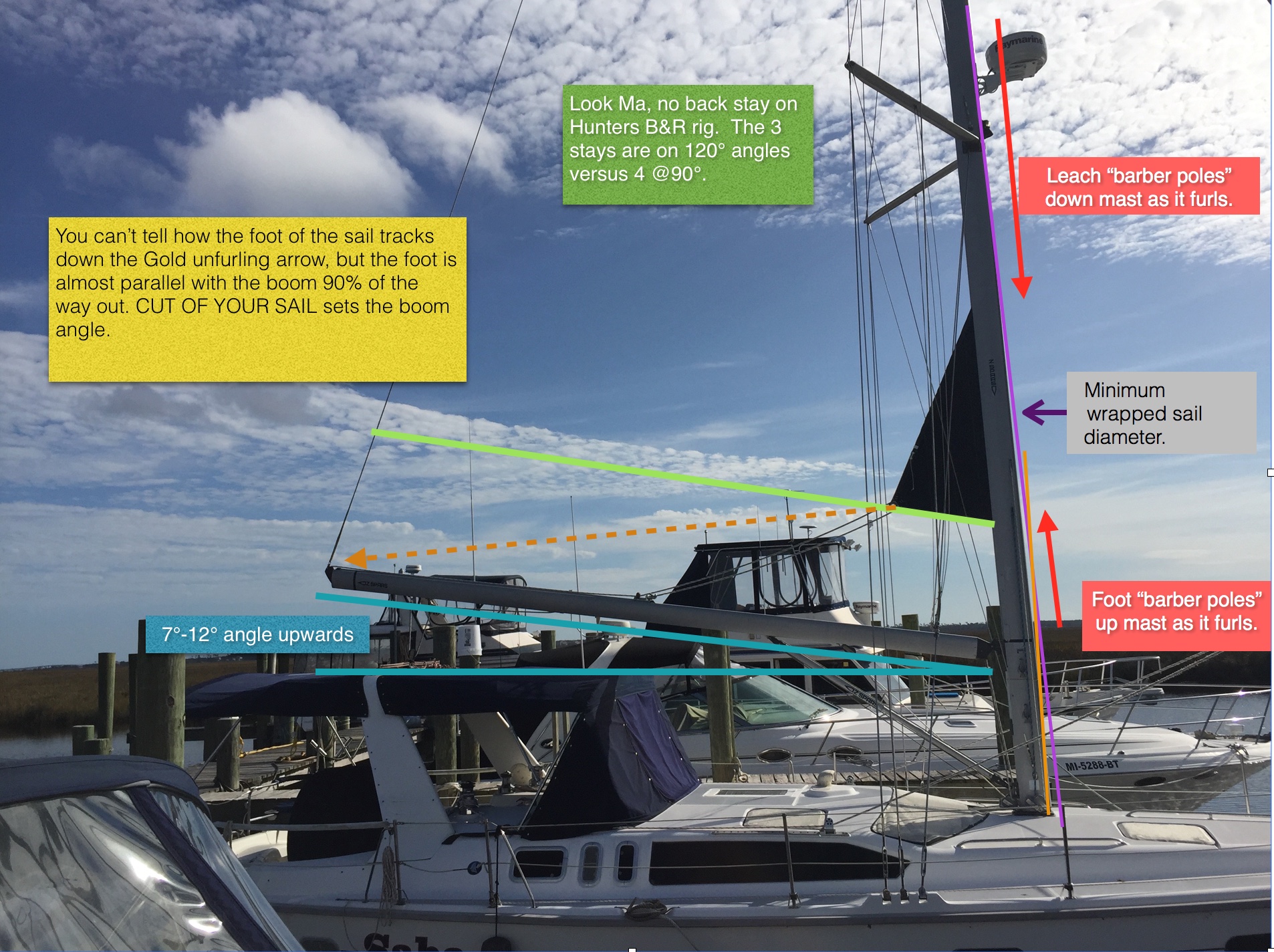

The boom should be angled up at least 7 degrees
The angle of boom is determined by the CUT of your main sail. My foot to luff angle is ≈80° so my boom is ≈10°.
The reason for releasing the main sheet and vang is...
The boom car cannot force the main, at an angle, to cause a jam at the foot!
My best description is that the boom "floats" while the main freely furls.
Maximum furled sail diameter is at the FOOT!
You can even see my mast "prebend" with the gold and purple lines.
Jim...
PS: My pict says Minimum diameter of sail, but I meant was "minimized" while furling.
