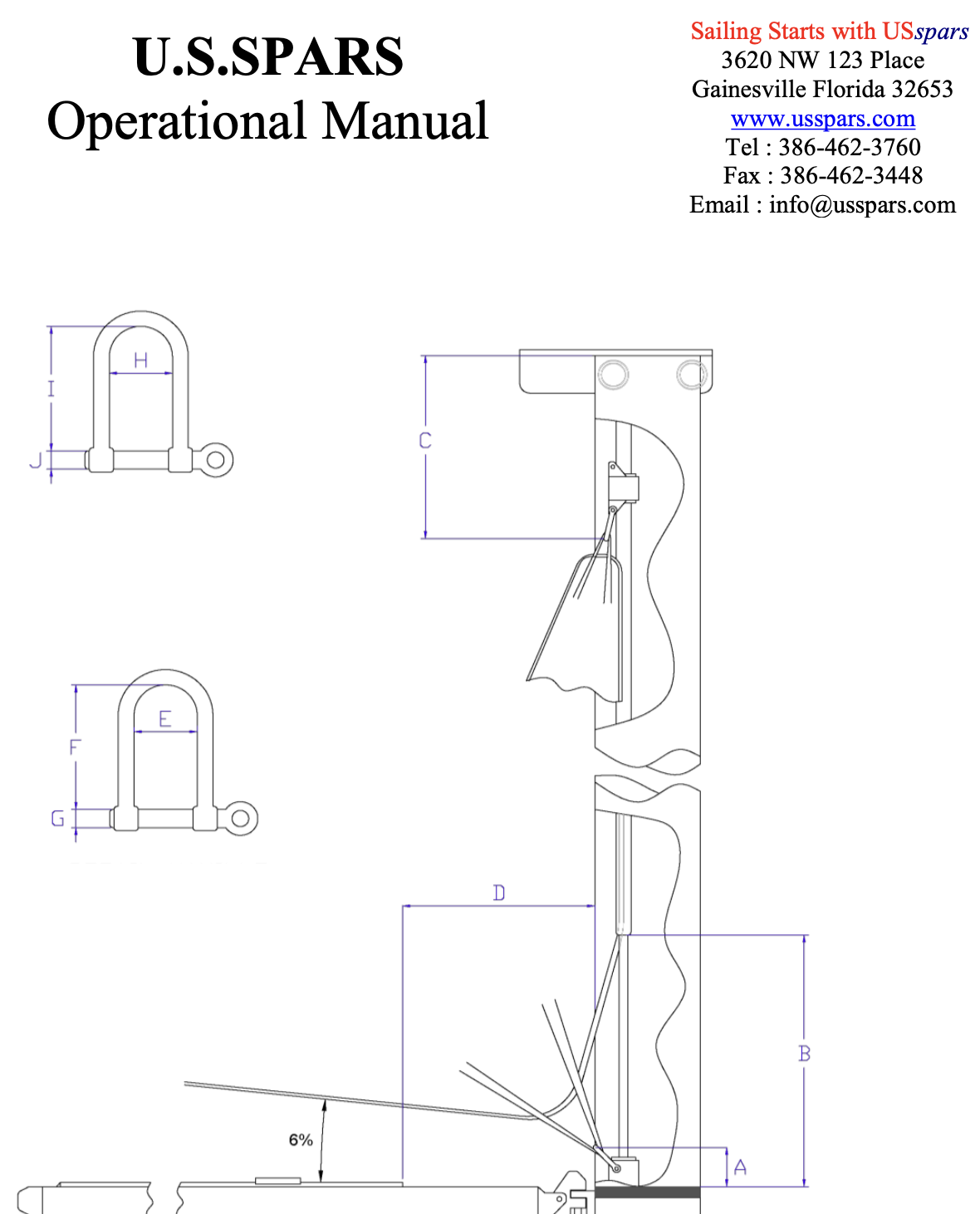

Hi have a Marlow Hunter 37.
With inmast furing system make z spars, the Swivel has to plastic parts attached to it to help stop it turning in the mast.
The front plastic is moulded to go over the sail slot is has two fixings to the Swivel the top one has a rivet but the bottom one is missing, looking at the catalogue looks like should be a bolt the runs up the sail slot stoping it from turning,but am unsure.
Does any one have a photo of this installed or can give advice. Thank you.

The lower connection, turns or swivels.
The upper connection is fixed by halyard tension.
If no help from this site per @Crazy Dave Condon , then call them which is Z-Spars USA.
