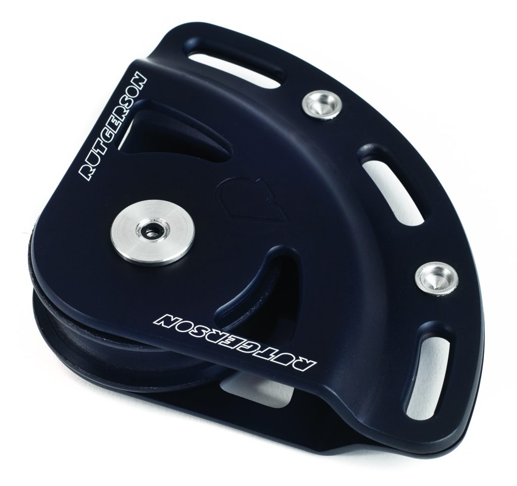

No, it is not part B9. It is closer to B8, except that the turning block is actually in the aft end of the mainsail. The attached picture (which you may have to enlarge) shows the outhaul line along the boom, then up to the sail and back to the outhaul car. There is a turning block which the line goes around; this is cracked. My question is how to replace this?

Thanks fo the picture. That made it easy.
It is called a “clew block”, and it’s supplied by the sailmaker, not the boat builder. The most common ones are manufactured by Rutgerson, Antal, and Bainbridge.
If there’s no pin, it’s probably a Bainbridge. Replace the whole block. I like the Rutgersons for strength and price.
