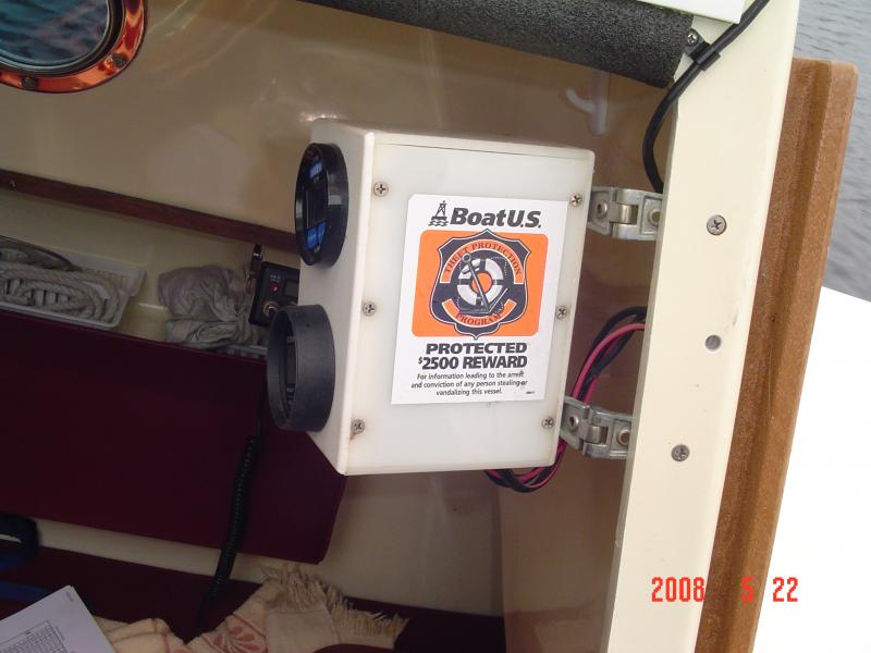

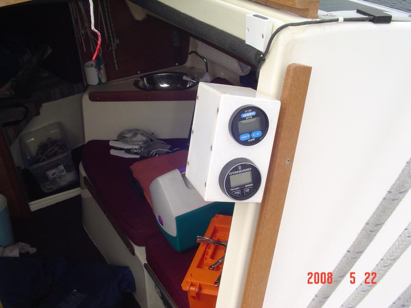

Wasn't it Red that had fitted an insert to the companionway with mounts for his instruments? Had a single board that fitted into this insert to allow passage into the cabin?
I tried a search for "Red" under authors but nothing showed.
Jan 24, 2005
4,881
Oday 222 Dighton, Ma.
Joe,
It may have been Red Rider. I remember someone on the forum who had a set up similar to that. I believe that Red owns an O'Day 222 and he's located in Little Rock AK.

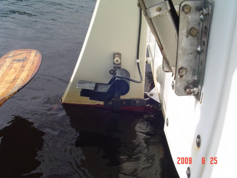

My friend Wayne built some swing out gauge boxes out of StarBoard and mounted them just inside his companionway. He has a Garmin GPS mounted on a swing out on the Port side of his companionway also.
He mounted a knot transducer on his rudder. He has it set up on a car with a track so that he can raise it out of the water to prevent marine growth.
