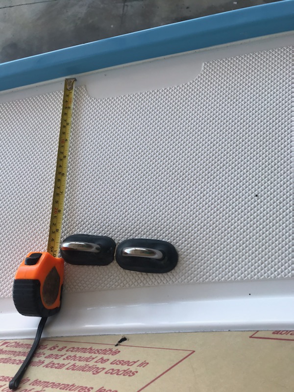

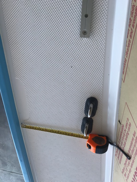

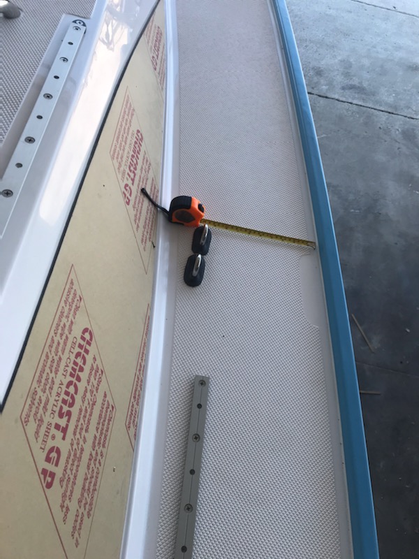

Looks like a lot of hardware has been added to support the shrouds, which begs to question: how secure are the shrouds on hulls 1-50? I was just thinking this exact thought a couple of weeks ago and wondering what the shrouds are really secured to and what is preventing the shrouds from pulling out. As some or all of this may be hidden from view, it's more of a mystery than a known.
Wonder what size sail they'll be able to fly with the outer tracks now. Can't be too big, unless they have a second set further aft.
Mar 11, 2014
224
1057
When I got hull 34 I went back to Gerry Douglas and asked that very question he called me and assured me that he knew what he was doing. I wasn't questioning his design abilities but asked how the connection method used on the 275 was different from each of the 4 previous Catalina in that the 275 didn't connect to the Hull directly. He explained that the Hull deck connection on the 275 was inverted from the previous boats and that the backing plate crossed the hull to deck connection and therefore it effectively was connected to the Hull.
Frankly, I accepted his explanation with the intent in the not to distant future of getting the backing plate redone so that there was a long extension flange that could be bolted to the hull.
Seems they wanted to go back to an overlapping Genoa and this was a requirement as you'll notice they added a track.
I have asked if this mean they have shortened the spreaders as well and will let you know if I get a response.

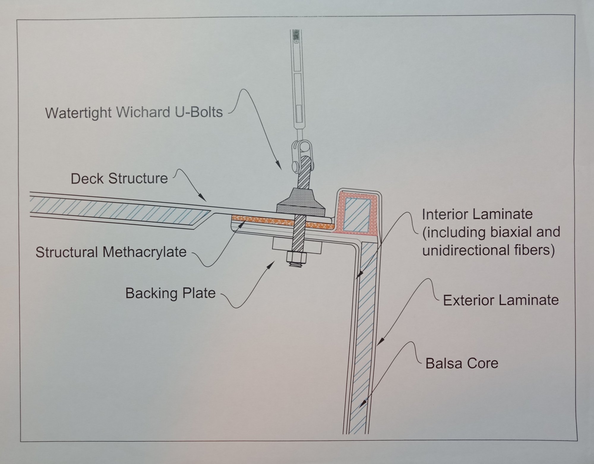

C275 outboard shroud connection detail from Catalina attached.
It surprised me a bit, had never seen a shroud fixing other than to a load path aligned chainplate or tie-rod. In any case I figure Gerry Douglas dependable track record for relatively conservative engineering & build (at least among production builders) is assurance enough.
But I do look at that new inboard tie-rod assembly pic next to my outboard detail... and hope the tie-rod set-up is taken standard from a larger Catalina model and/or in any case is quite a bit over-engineered for this boat. If not I take it back.

The original chainplate attachment is NOT COOL, and I don't care what GD says. That need to be attached to the hull in SHEER, in not coupled through the deck in tension. I've see that design fail.
In any case subject to tension. Assuming you meant 'shear' shear failure would be the problem if the original fixture goes for anything other than corroded 316 irrespective. Unless you're talking about laminate failure at the gunnel where did you see a meth adhesive bonded lap of solid laminates like this fail under shear of a back plated wichard for a 5-6mm shroud load?
