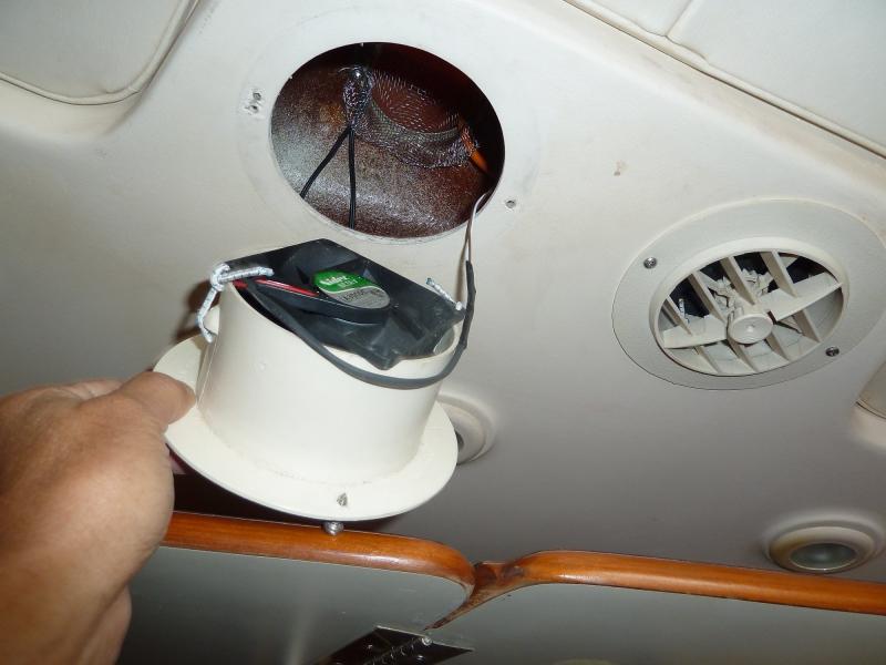

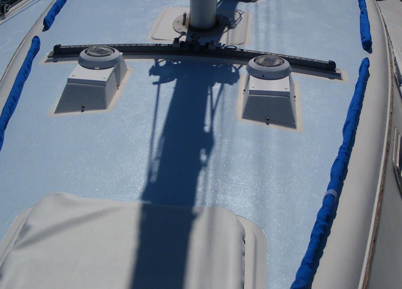

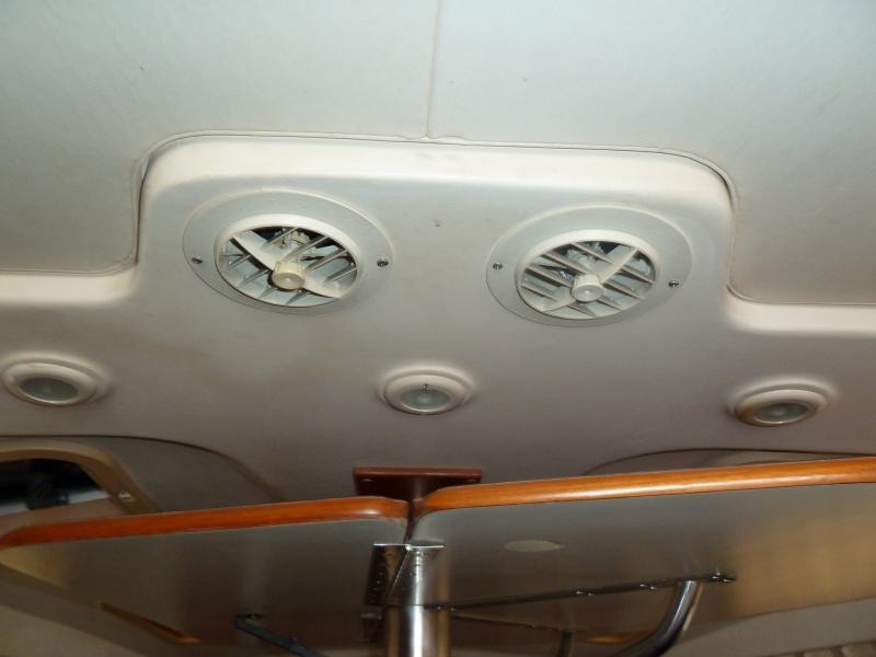

I've two cowling on my coach roof. The dorade box isn't directly couple to inside cabin so instead, I install 2 computer fans inside cabin roof lining vent and wire it to a solar panel outside on deck. Thus I've 2 powerful fan blowing or sucking air (can be turned around) to cabin working with the Nicro Day/Night Solar vent at forward hatch to freshen the air inside.Picture show the dual vent and another show that behind it is a computer fan driven by solar panel (not shown) mounted outside at coachroof. Cabin air blown out through the cowling. The SS gaze is to prevent rats from entering cabin.
To change between exhaust & air inlet, just turn the fan around as the computer fan won't reverse by changing polarity.

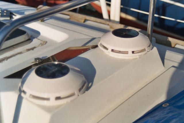

I istalled 2 solar vents on my H28.5.
A 3 inch dia Nicro 48 hr Day/Night solar vent inserted just forward of the mast on the centerline- cause years ago the yard in stepping the mast put it down hard w/o a life jacket seat under it and put a hairline crack in the fiberglass there- so I used the solar panel to solve 2 problems.
I installed a 2nd on the smaller mid cabin hatch- this is non battery solar Nicro 1000 and its also same diam as I only had to buy 1 Milwaukee hole bit. Note: They are NOT 3 inch "holes" - slight larger to accept the housing/shaft.
The Nicro 100 works great 365 days per hear - only in the daytime. The forward Day/Night battery driven one works with an on/off switch and has a shunting collar and I let it run 6 mos per yr. This keeps the boat fresh smelling - works great for me.
Install- into the acrylic/lexan hatches- Get a lexan pilot bit and turn it slowly without much of any force- let the bit do the work.patience is a virtue here. Once the pilot is in you can switch to the hole saw bit- don't load that either - light and easy does it not hard force. The sharp milwauikee bit will turn slowly and etch its way thru- you might !!slightly wobble!! the drill as you get almost thru it but dont' speed up the drill- and it should go fine. It will shave off like auto body filler.
When I inserted the forward vent I shot my pilot hole thru the cabin top and then slowley cut thru the deck with the hole saw- then shot up from the bottom thru the liner using the original pilot hole from the top- worked well- you might want to totally fill in the open space of the shaftway (deck to liner- or caulk the sleeve/shaft insert of the solar vent very well- don't want water gettin into the core!!!
What kind of solar panel did you mount the computer fans too? What about the battery pack? Was it some kind of combined package? I looked on amazon and found some 5 watt panels?
I removed my vent cover and its just a single 4' hole in the cabin roof with 2 cowel vents. I nabbed a cpu fan from the garbage and it would fit perfectly.

I had a Sunsei 5W powering these fans till I stepped on and broken the panel. Now I use the Powerfilm Rollable 14W. Placed it on top of sailcover (sits nicely, secured between the lazy-jack and facing sun any time of day). No battery connected. Thinking of wiring the panel to house bank with 5-ways selector switch for options like, 1)OFF, 2)Solar->Fans, 3)Solar+Batt->Fans, 4)Solar->Batt & 5)Batt->Fans.
I think single fan is good enough, but get a high volumn if possible. Load is probably about <200mA so a 5W is just about adequate given you may not have good sunlight through out the day. No night operation unless you wire in a battery. Then the solar panel Wattage may have to go up some.
