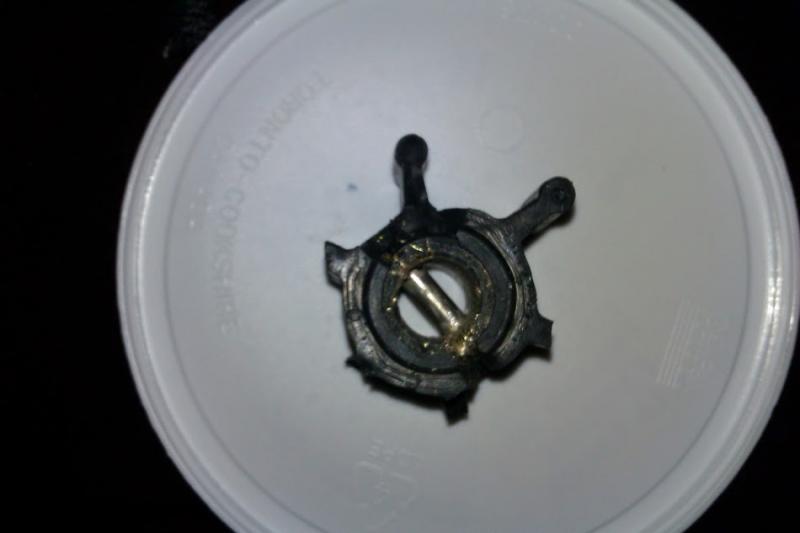

Aug 13, 2012
533
Catalina 270 Ottawa
Some last longer than others. This one had one season under my management, but its age is unknown.
If there is any doubt, the impeller had 6 vanes.
