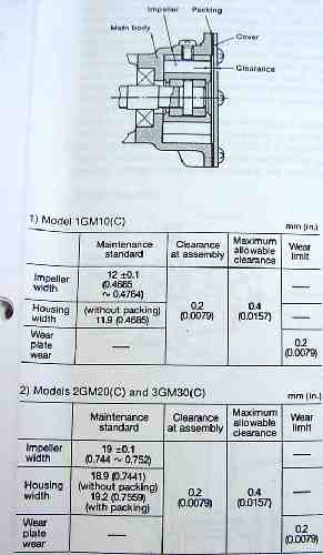

Replacing the gasket with silicone not a good idea, unless as some kind of at sea emergency operation where no gasket is available. Even there would be better to repair a torn gasket with a sealant and put it back on till a new one can be obtained. The silicone can extrude into the pump itself, not a good situation, especially if it sets before the pump rotates and second, tightening the screws down will reduce the clearance to zero. The 1gm, 2gm, and 3gm pumps are designed with the thickness of the gasket providing the design clearance between impeller and pump body. Figure from gm manual attached shows that without the gasket, an interference situation will result since pump housing width is less than width of impeller.
