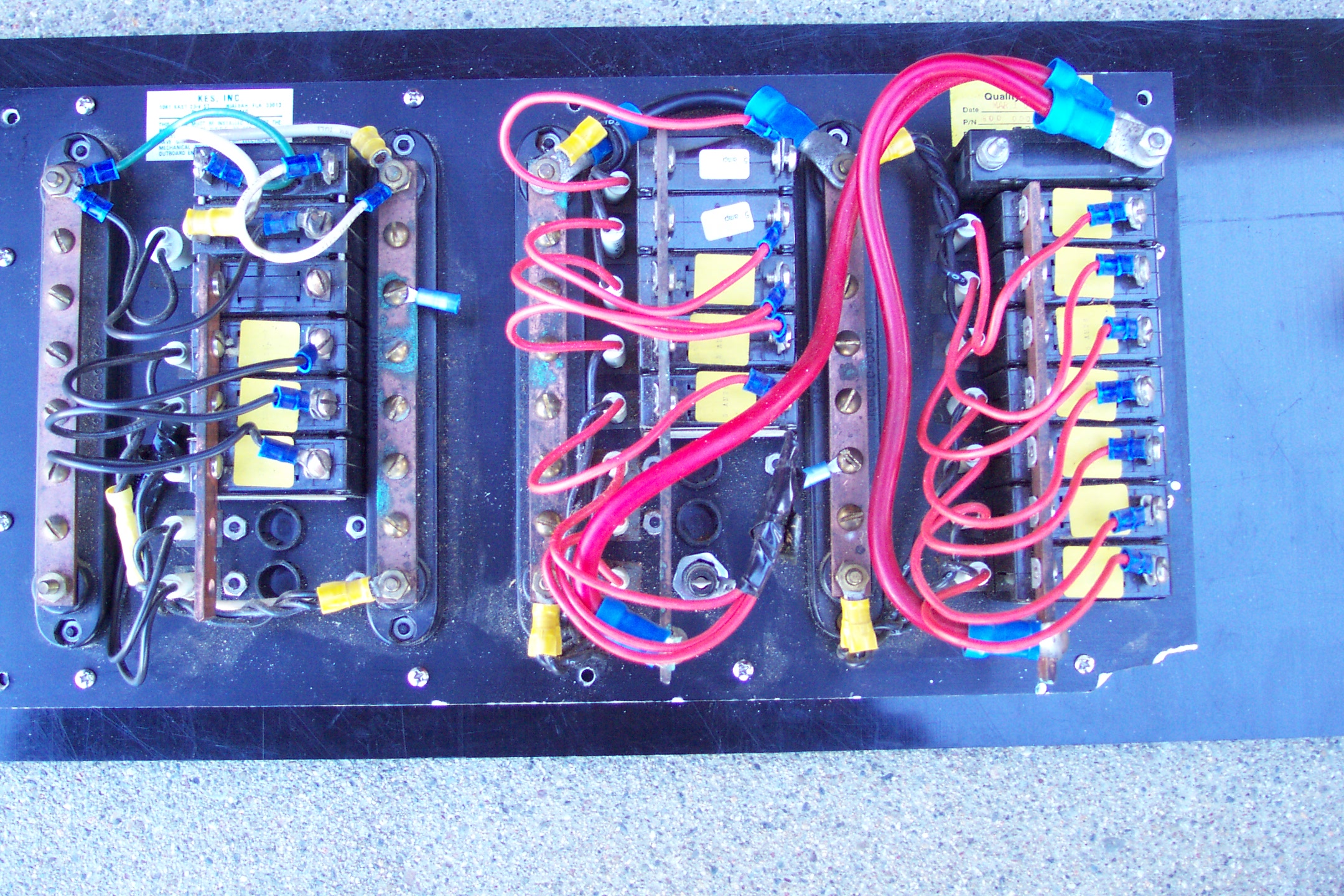

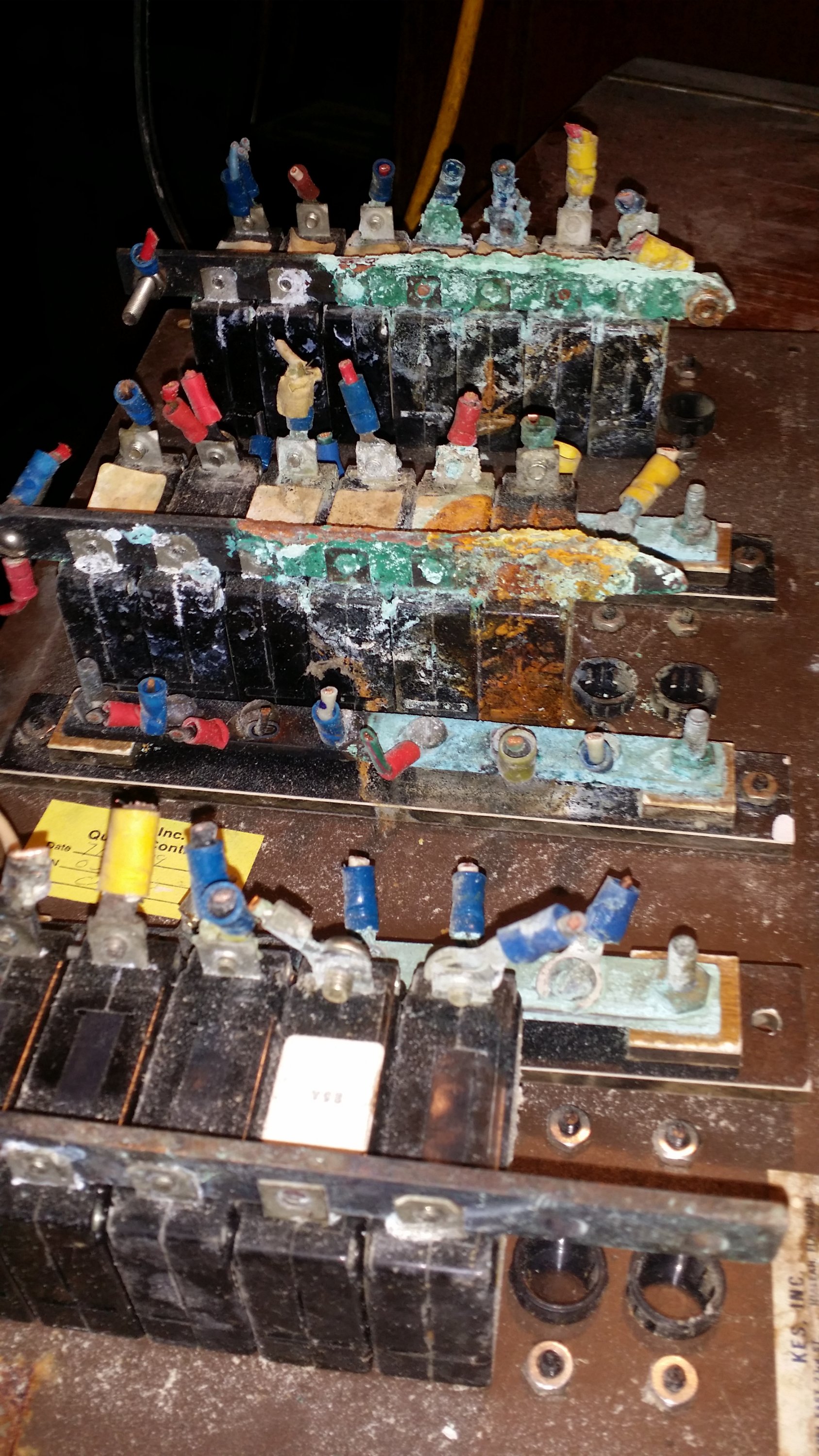

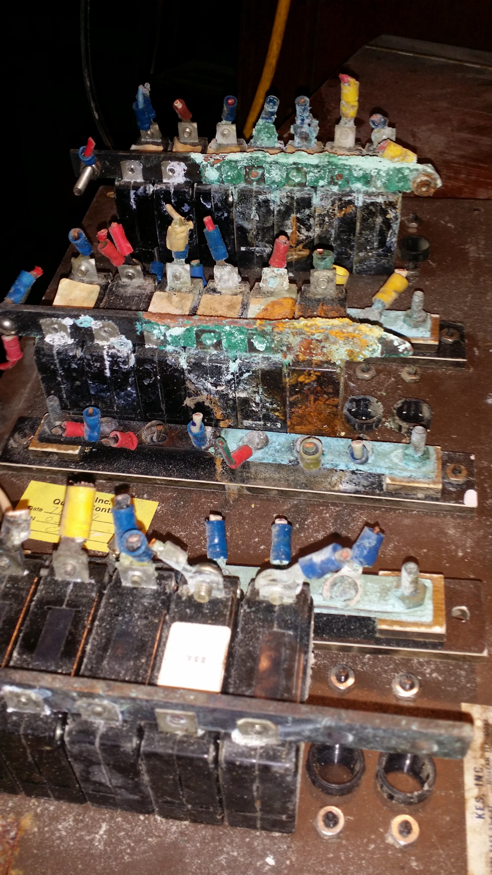

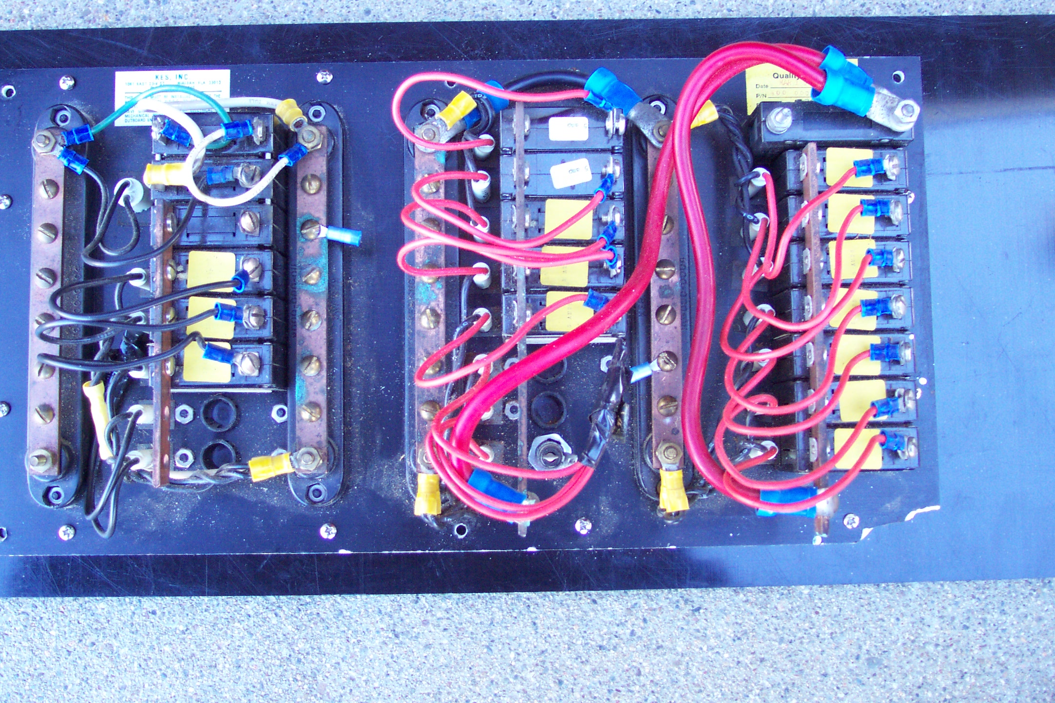

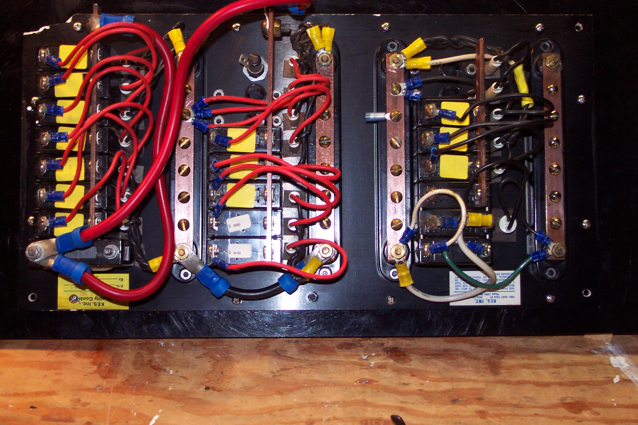

This is the back of my current fuse panel
Holly Molly. And I thought I had electrical problems. You did say this was a Hurricane recovered boat...
