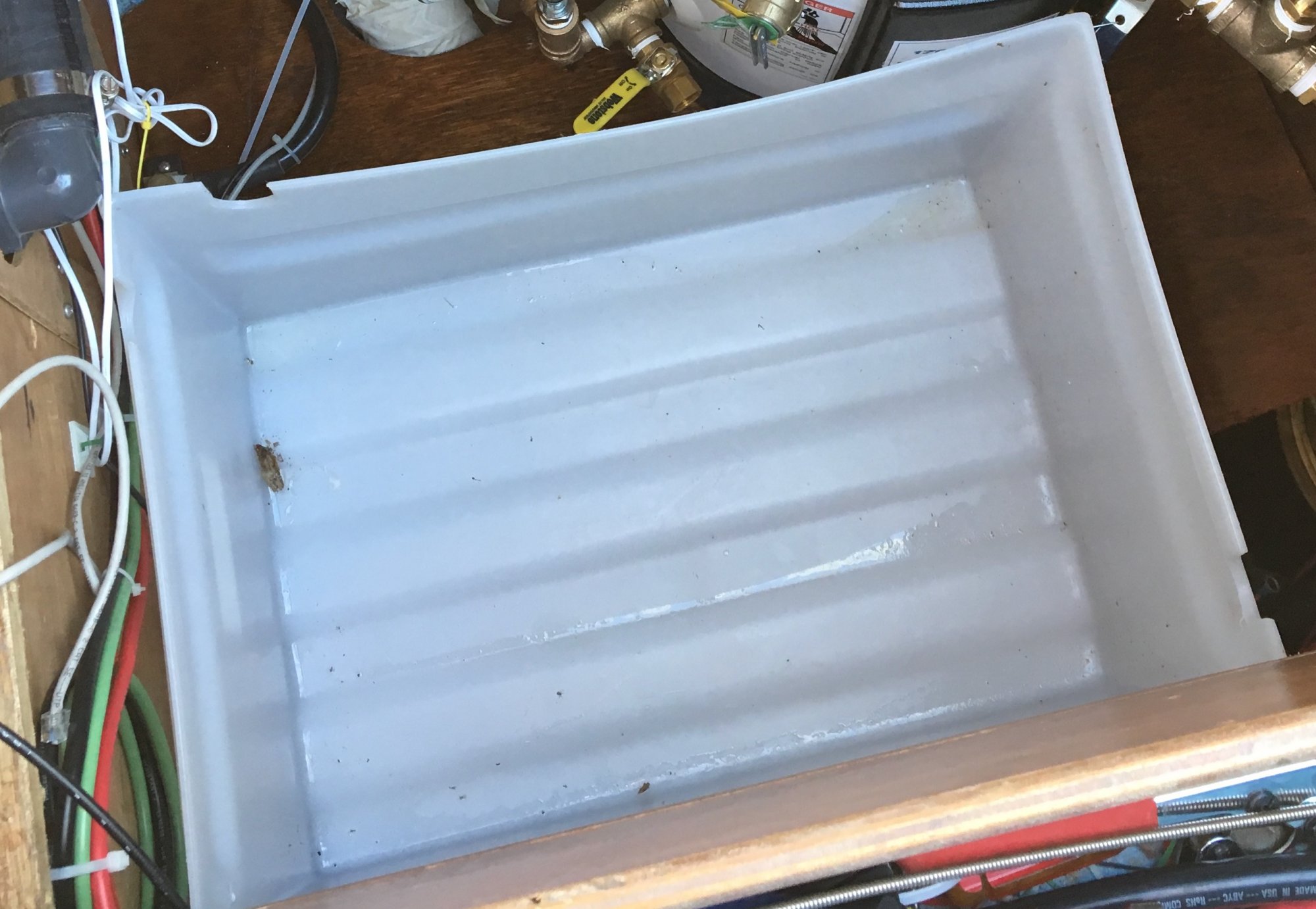

Looking at the picture for the battery box's shown, how do you secure the box to the boat. Not sure I"d just want to set it into the location. I see they list straps to hold the top on but I don't see a way to secure the box itself. I believe the Compass Marine advice is to secure the battery box. Like the look of them but wonder how to secure them.
The covers we have on our battery containers have loop slots through which the strap tie downs run. No clue who makes them but they exist.

@Don S/V ILLusion Thanks. Am I to understand that the straps go around the box and top and then pass through something secured strap or fitting on the floor of the area where they are located. Still trying to visualize. I like the boxes and will take measurements to see if they will fit.
13,013

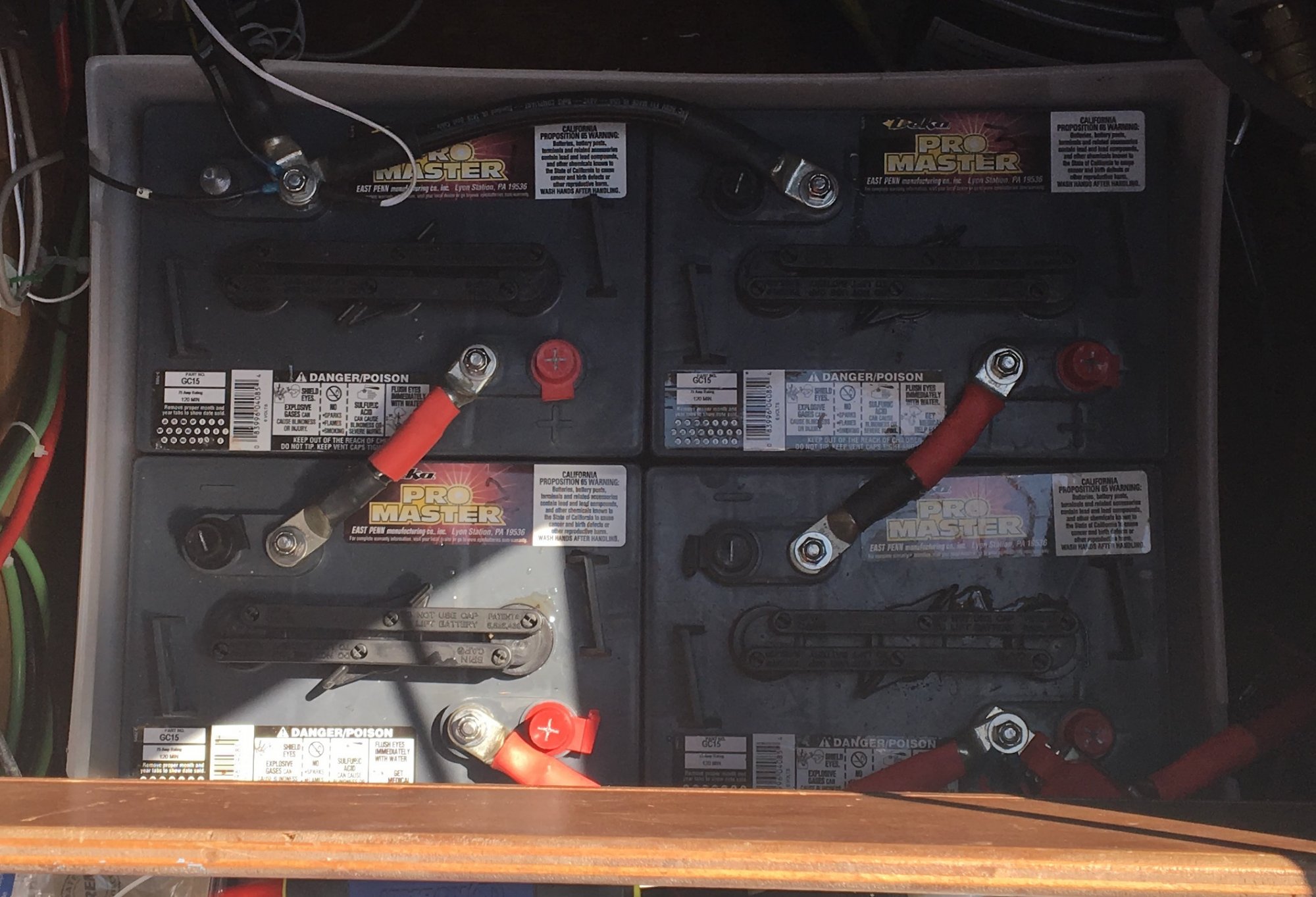

The bottom of the box is not flat, it is corrugated. Straps run through the corrugations and over the top of the box and are secured with the kind of clasps Maine Sail recommends. The straps are secured with footman loops that are secured to the floor. Looking at the photo below, the straps ran through the 2 outermost raised areas.

@dlochner Thanks! It the footman's loop that was missing from my visualization. It is attached to the floor and the straps go through it and over the box lid. Now I understand.

Dave,
Because the bottom portion of your photo is blocked out when I view it.

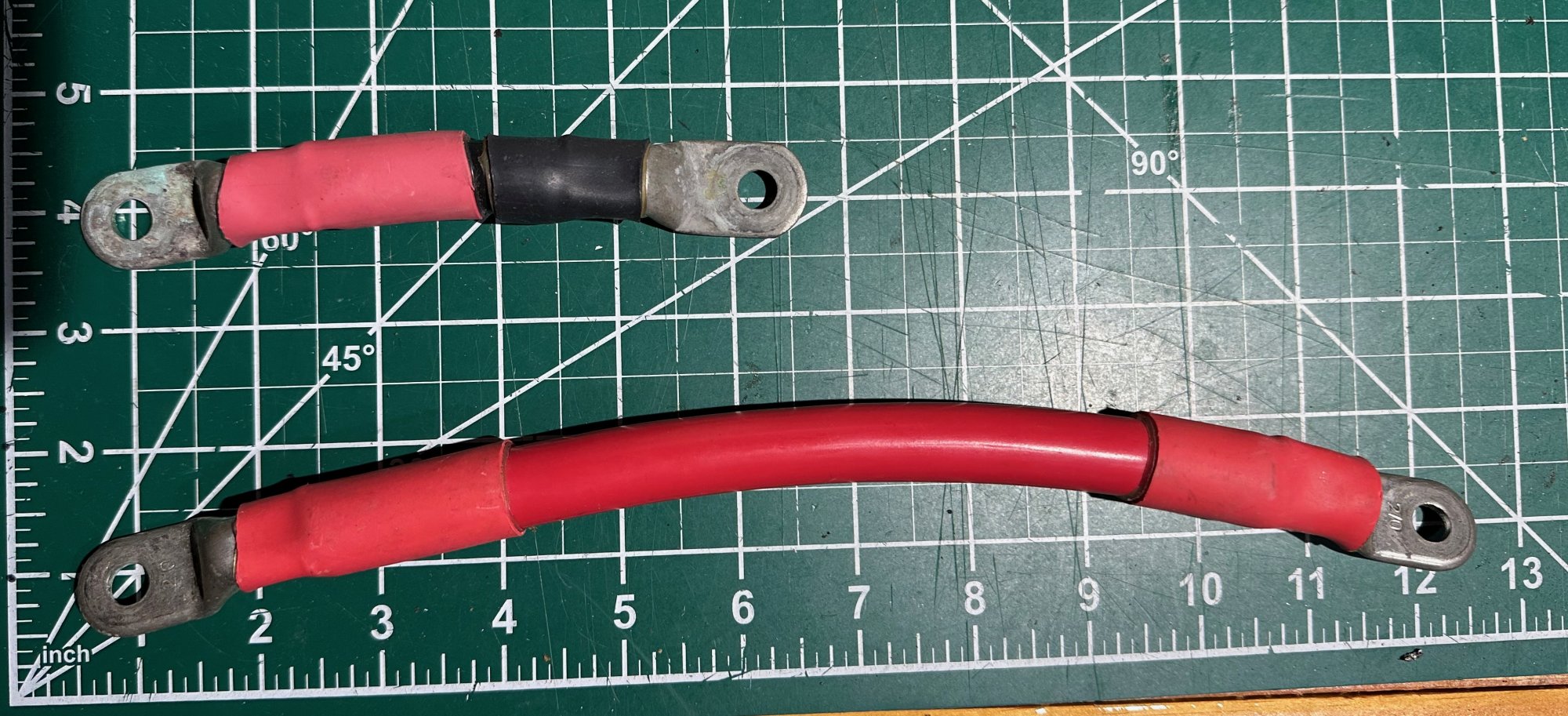

Correct me if I am wrong…..Am I seeing 4 - 6 Volt batteries wired in a Series/Parallel Combination? Giving you the 12 volts you want but doubling your amp hours? And are those about 6 inch long negative to positive jumper cables?
Just for my reference, so I don’t buy cables that are way to long.
Thank you for the clarification. Sorry for the blocked out image I‘m getting. Foolish iPad!
13,013
Dave,
Yes, there are 4 batteries in a series parallel configuration. There is pocket for the weather boards that hangs over the edge of the batteries obscuring the image. Good eye on the sizing, the short jumpers are 6 ¼ inches center to center on the lugs and the long ones 12 inches.
