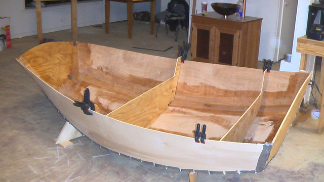

A few days ago I recieved the plans in the mail for a Prameke 7'8" sailing dinghy and I have started working on it. So far (one and a half days) I have the hull stitched and glued together! I think I am making pretty good progress.
There she is, finally took the shape of a boat today!
I am documenting the whole build with my video camera, kind of making a "how to" video. I am also posting about it in my blog where I talk about the build and post photos and videos.

BTW: it looks like your "living room" has a concrete floor. Probably want to leave it that way till after all the glassing and painting.

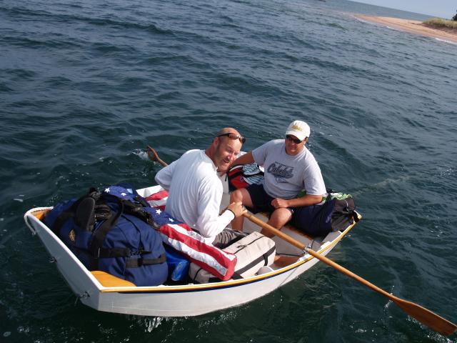

I love that I can get our family of four to the beach and back in one trip. I added a photo of how NOT to let guests pack! but it sure shows how much gear you can get into her!
My only complaint is that she's a bit tippy while trying to get on board, once seated inside though, she rows very well for such a short little thing.
