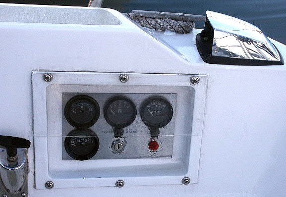

I relocated my panel from the port cockpit seat riser to the stbd coaming. I chose the stbd side to avoid the blower. I'm fortunate to be experienced with fiberglass so repair of the existing hole was pretty easy. I've seen others who put various installations where the old hole was instead, like a winch handle pocket or a cockpit shower.

Rag Bagger,
Thanks for the photo and note. My instrument panel is located above the port seat and the key attacks my feet as I climb onto the seat to get around the wheel. The panel is as it was built. It's interesting how Catalina tweaks the details from one hull to the next. I'm going to pursue the ignition replacement from Catalina Direct which allows me to remove the key once the engine is started.
