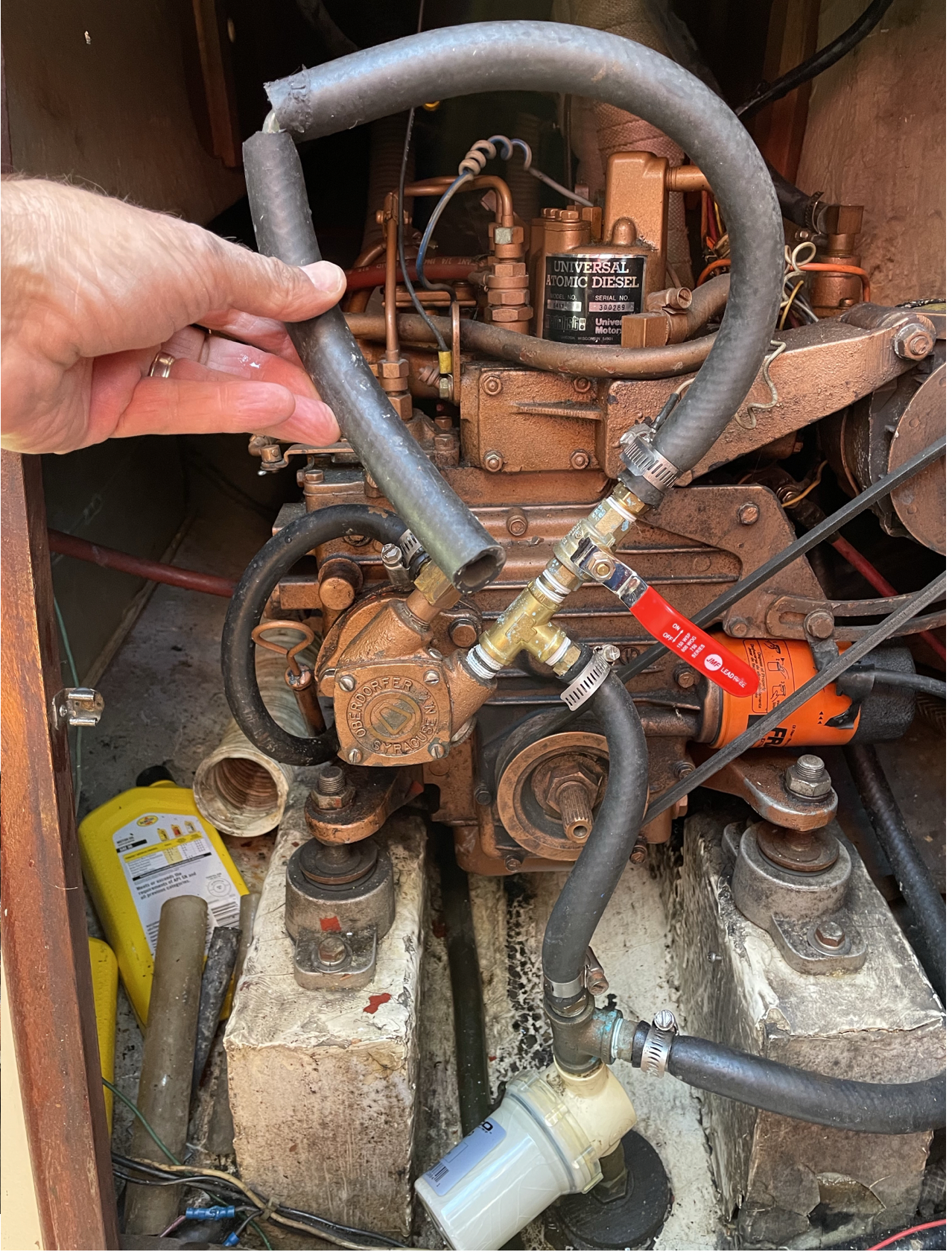

If I don't need hot water I don't need this, right?
xavpil
Sep 6, 2022
376
Jeanneau Sun Odyssey 419 Milwaukee
Diesel engine, Universal Atomic 5411
I don't intend on having hot water. So I don't need the red handle right?
May 17, 2004
5,900
It looks like that valve is on the same side of the pump as the through hull? If that’s the case that’s the intake side of the pump, so it wouldn’t be involved in a water heater circuit at all. Assuming it’s on the input side it’s more likely that it’s a way to flush the raw water circuit. That could be done to either flush the block with fresh water, or to run antifreeze through it when winterizing. You’d put that cutoff house into a bucket of fresh water or antifreeze, open the valve, close the seacock, and run the engine.
Mar 6, 2008
1,417
This raw water pump is needed to keep the engine cool. The water heater uses the antifreeze water loop to heat the fresh water
xavpil
Sep 6, 2022
376
Oh man awesome explanation! And I updated the picture .
Thx a lot.

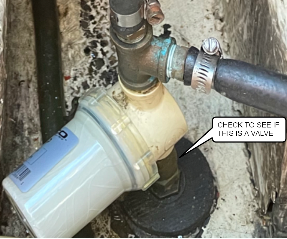

Presumably there is a valve (seacock) between the strainer and the thru hull? I assume that black disc is the backing plate for a thru hull and there is a valve on it but it's not visible in the photo.
Sep 24, 2021
386
Beneteau 35s5 Telegraph hrbr Thetis Island
A perhaps more interesting questions is where does the teed off line above the strainer go ??
Jan 4, 2006
7,443
It looks like (I'm hoping) there is a valve in there.
@xavpil , please check to see if there is a valve there and ensure that it works. Big safety item.

i don’t know what a valve would look like and where to look for it….
If the down side of that strainer goes straight to a thru hull then you have a big safety issue. If that line leaked or broke anywhere you wouldn't be able to shut off incoming sea/lake water. I.e. your boat could sink. Every thru hull should have a shutoff behind it.

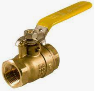

You asked and I be tellin' ya :
Something like this should be located in between your strainer and the thru-hull as I mentioned in post #7. When the handle is in line with the attached piping, it will be open to allow water to flow. When it is turned at right angles to the attached piping, it is closed and does not allow water to flow. Just make sure you got one in there and that it works, otherwise I won't be able to sleep at night thinking about your predicament :yikes: .
Oh man this IS a valve!! I didn’t even told it because once again, it seemed like the name for an important ad specific part that even told wouldn’t find!!
thx for taking the time
and actually there is one. Old. Very old. And I a, changing it to something reliable

Are you sure you have one behind the thru hull? It's not evident in your picture .
