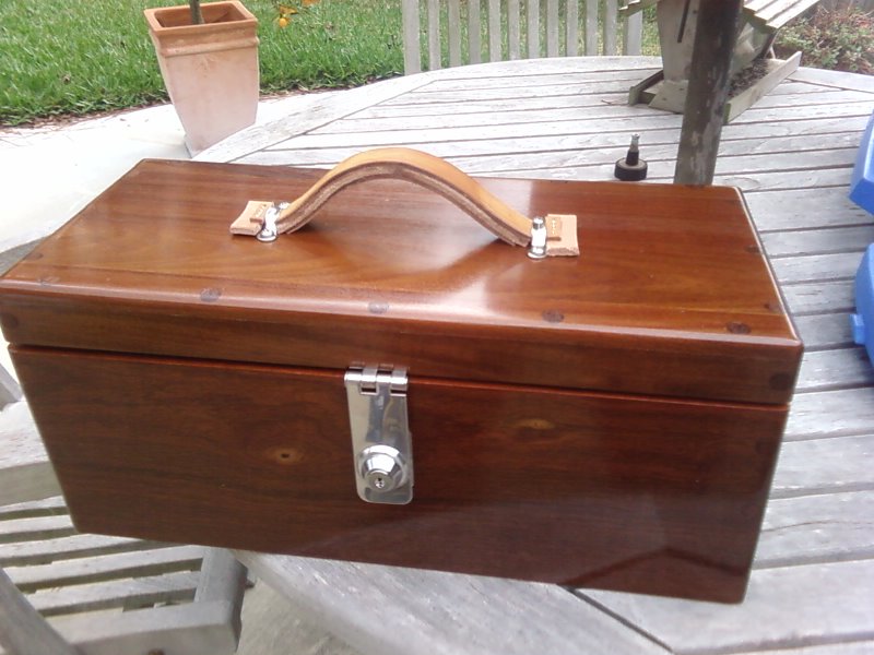

Look for Ipe (pronounced E-Pay) .. It is a strong outdoor kinda wood like teak and just as rot-proof.. It is used in outdoor patio decks and such .. Picture is a box my buddy made of some scraps that we picked up at a deck job.. It is finished with clear Formby's Tung oil .. There is no coloring stain, that is natural color..

Thanks! Claude, that looks great! Hadn't thought of cypress, Ross. Maybe I can scoop up an old pirogue ... ;-)

You'll get some workout lifting hatch boards made of ipe and if you should drop one it will do damage to what ever it hits :eek: I'd reconsider using that stuff....its good for small items or something screwed down.....I used the stuff for blocks under my traveler
