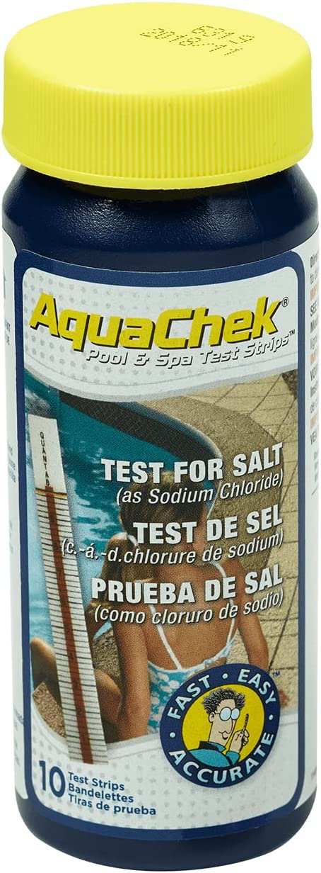

Here is something that might work..
AquaChek Salt Test Strip Titrators for Pools - Salt Water Pool Test Strips for Sodium Chloride - Quick and Accurate Results - Professional Water Quality Testing Kit (10 Strips)

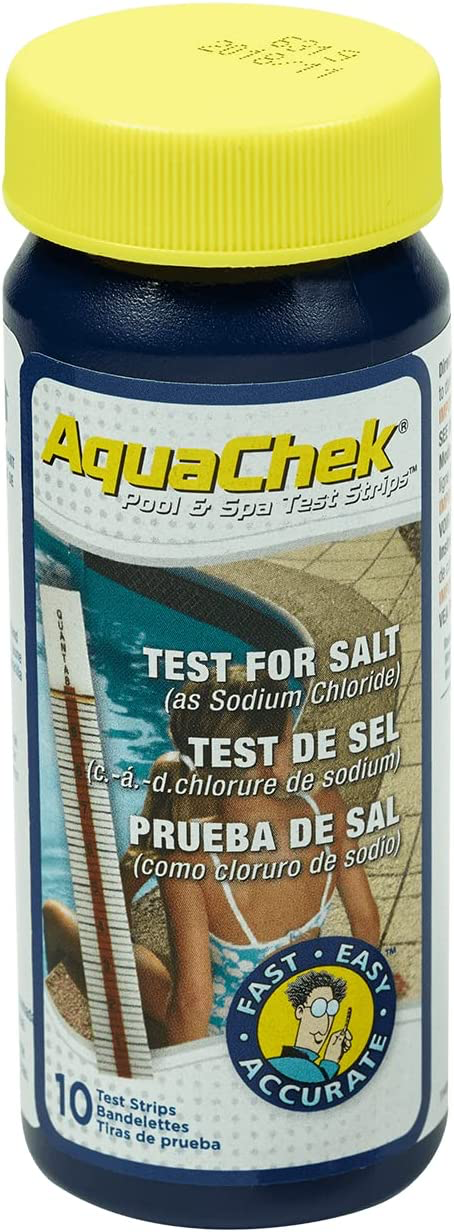

Those test strips will work... alternatively, if you have a local community college or university, you could contact the chemistry department and ask if you could have a pinch of silver nitrate. Dissolve the silver nitrate into about 2 milliliters of distilled water (or water from your tap if it is not chlorinated). Then take a sample (about 10 ml) of your bilge water into a glass and add the silver nitrate. If it turns milky white, then you have salt water in your bilge. The silver combines with the chloride and makes a white insoluble solid (collodial) suspension.
This is a part of a routine analysis (gravimetric titration) and all chemistry departments keep some of this around. You can also buy silver nitrate on Amazon:facepalm:
