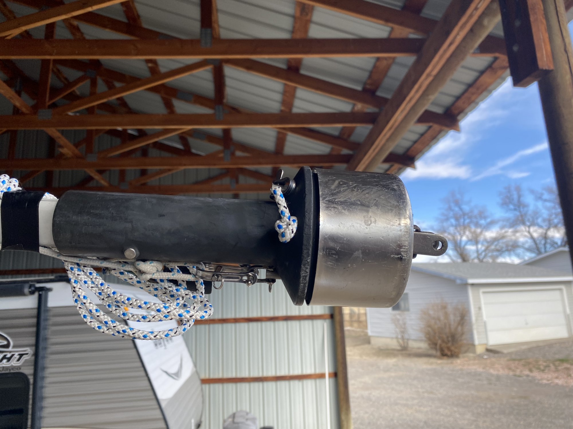

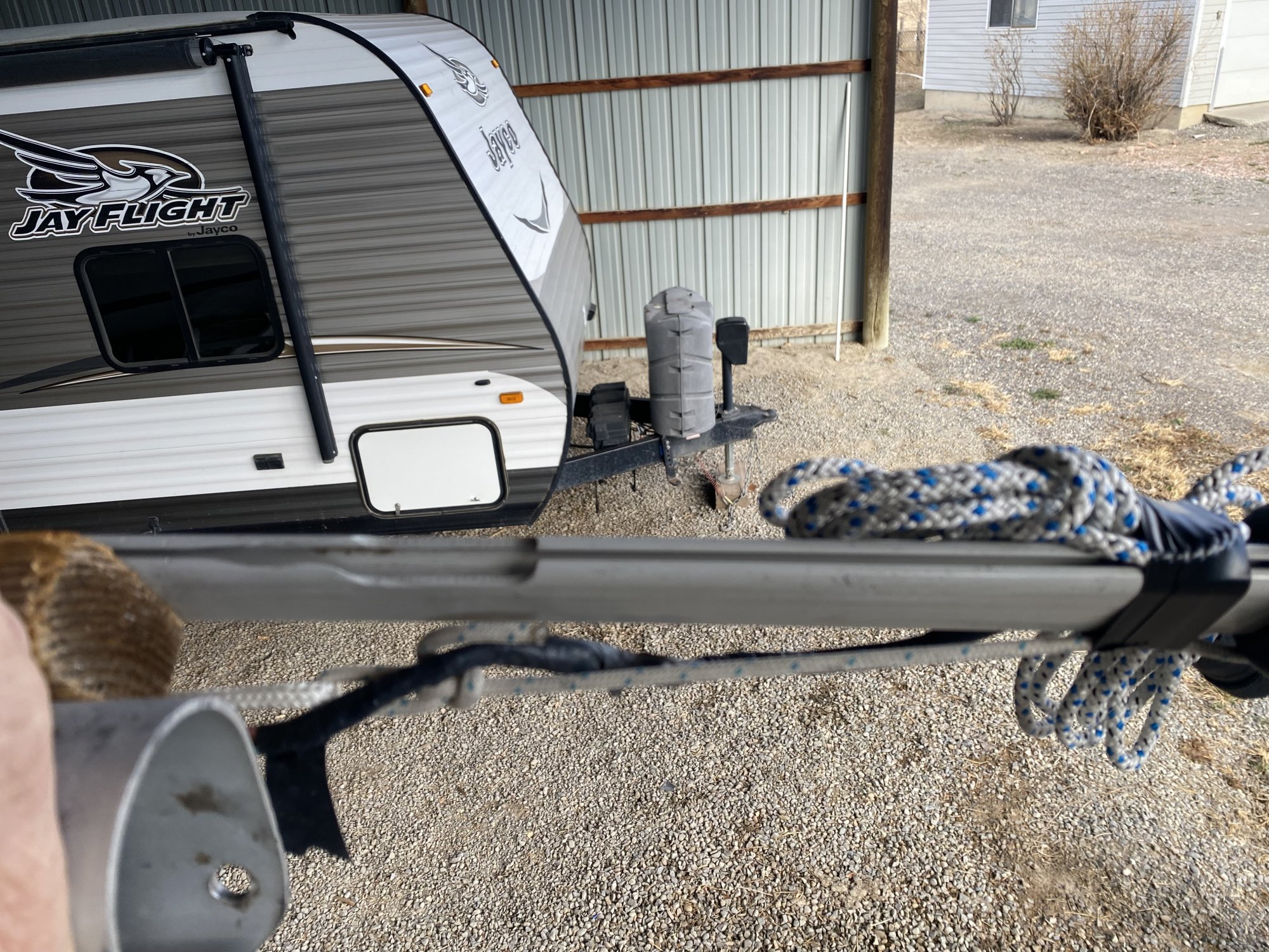

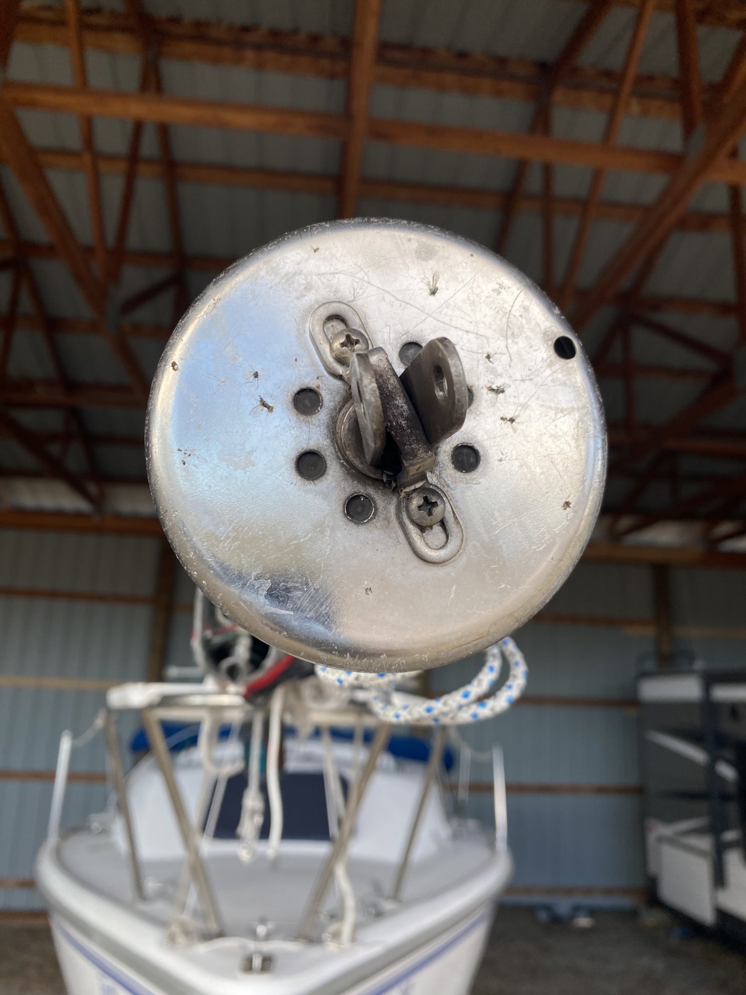

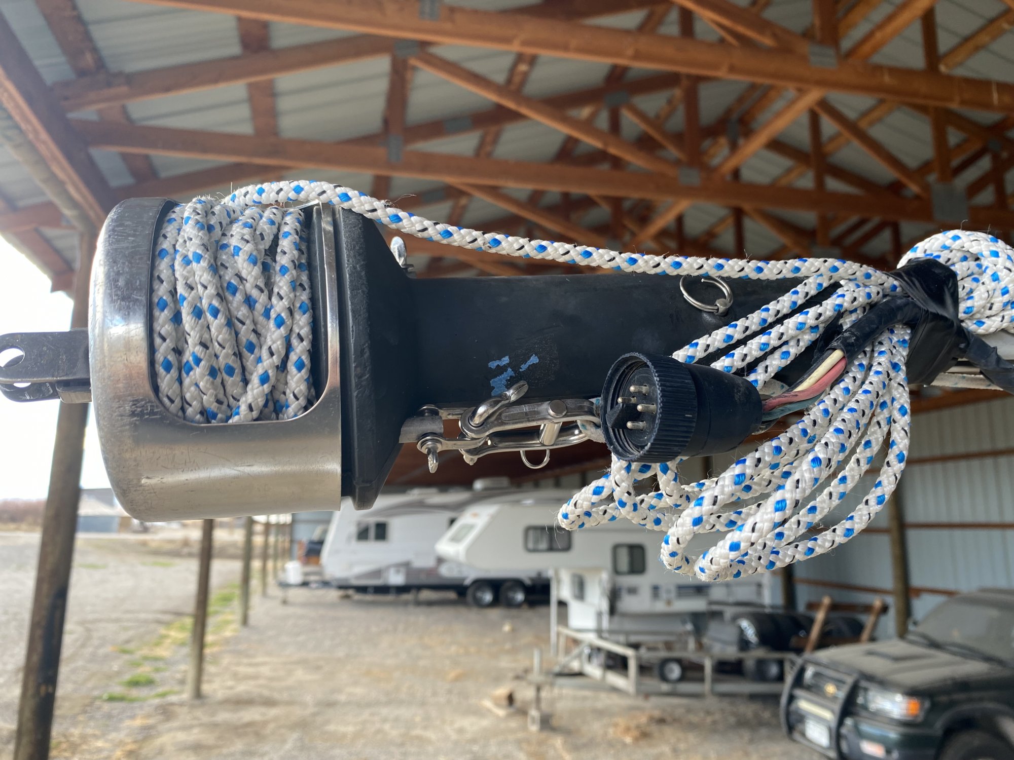

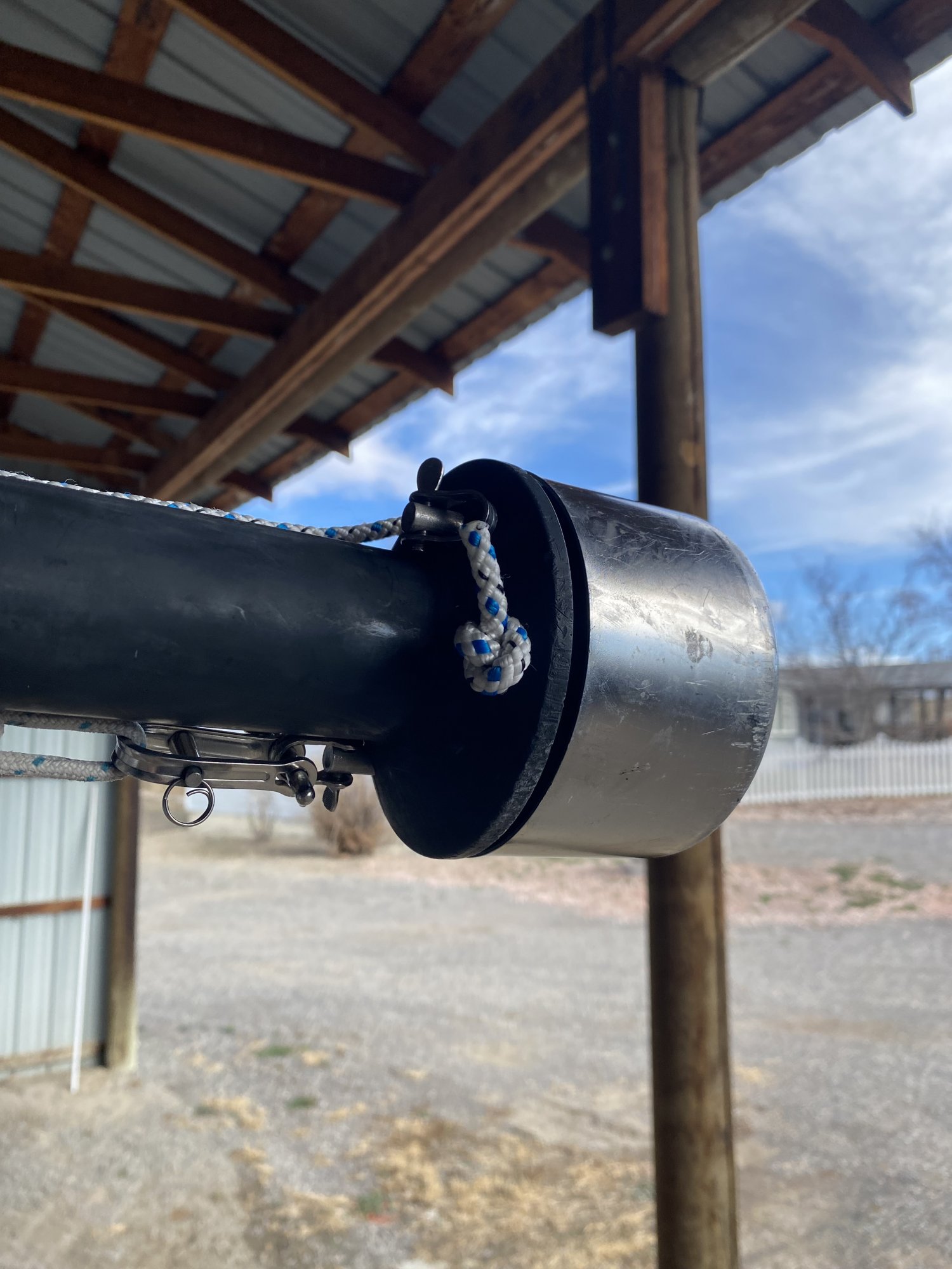

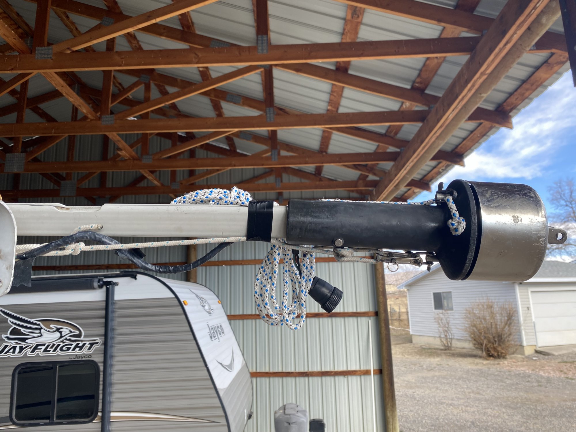

Hi friends, New to the forum here. My wife and I have a sweet 2007 Cat 22 Mark II. We are the second owners going on 9 years now. . We are in the process of replacing the sails through CD. We are downsizing the headsail from 150% to 135%. CD wants to know the brand of rolling furler we have, but for the life of me and I can't find and name or brand on the unit??? Anybody have any ideas by looking at the attached pictures?. Thanks!

Send them the pictures. The last picture, image #6, especially. It will help them determine what size luff tape they need to sew on the sail.

Dont forget measured forestay length including attachment hardware.

135 seemed to be the best for my furler based on my average wind conditions. I have a cdi ff2 (looks exactly like your pics but with the cdi logo still on it).

Yes...that is a CDI FF2 furler. It's what came standard on the Cat 22 mkII. I too dropped from the 150 headsail to a 135 on my mkII and love it. Sure you can "roll in" the 150 in higher or gusty winds, but you end up losing sail shape when you do. The 135 seems to be a good compromise.
