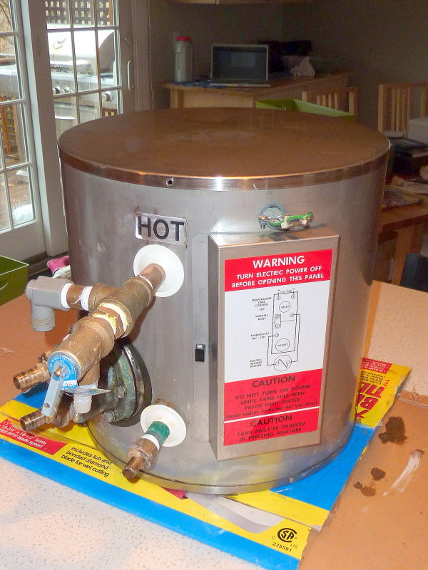

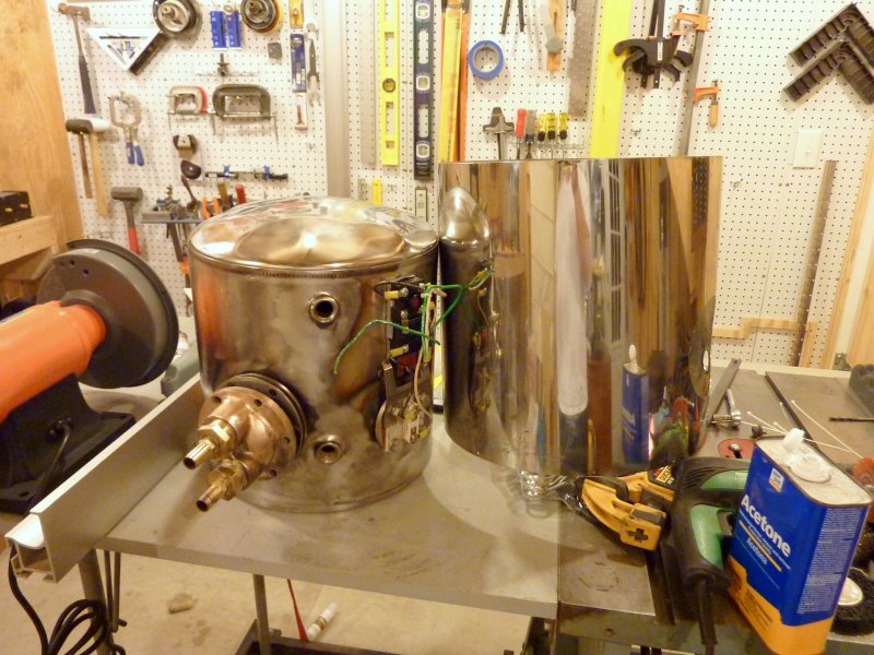

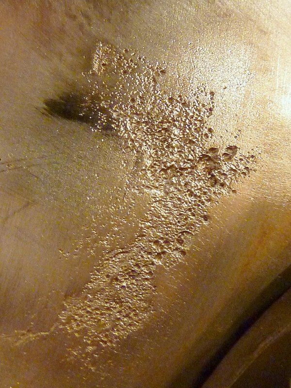

Not real happy about the old tank dying but that was a combination of a bad design work by CS, with the tank well having no drain, and a poor choice of insulation by the tank manufacturer. Stuff happens...:doh:
