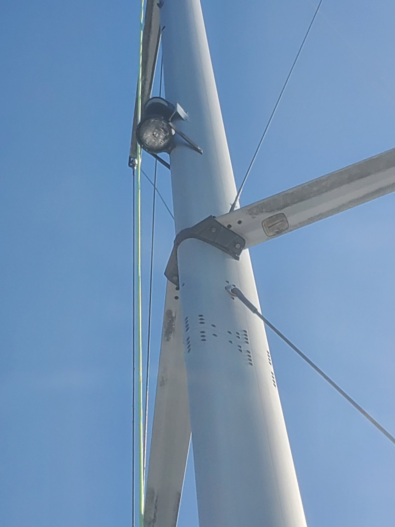

Looking for some help identifying this deck light on my 2002 380. So I can get a bulb before climbing up.
23,548
The way I've always done this is to take a photo, as you have alertly done, and then go to a marine catalog, like WM or Defender, and find the fixture. These days, with new LED lamps, it may be worthwhile to consider changing the fixture if you can't find just the replacement bulbs.

That looks like an older fixture I had on a late 80's boat. Mine was incandescent. I think this is the modern version:
Or this:
Or this:
I know you just want the bulb. But these things are aging out.
BTY I think the deck light and the steaming light are supposed to be wired separately but I don't think mine were.

I had the 1st mate go up the mast yesterday. The original bulb was a Wagner SU 4411....I replaced it with an led bulb......Par 36
90 watt.

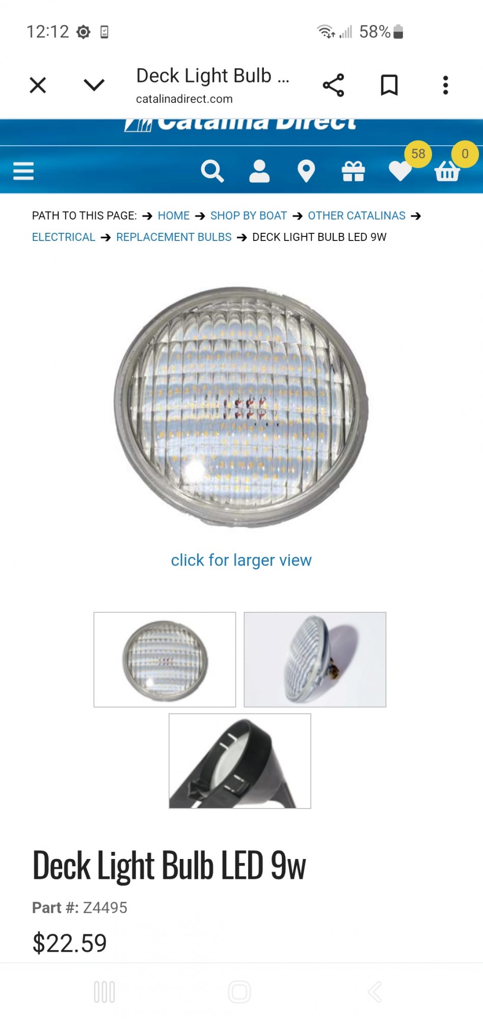

Late reply: I replaced the bulb in the deck light on my 2007 Hunter 41AC a few weeks ago and it looks similar if not the same. The bulb was a 4406 Par 36 tractor headlight rated at 36 watts. I replaced it with a VStar Par 36 "landscape bulb" that is an LED bulb rated at 60 watts equivalent but drawing 9 watts. I found it on Amazon for about $20.
