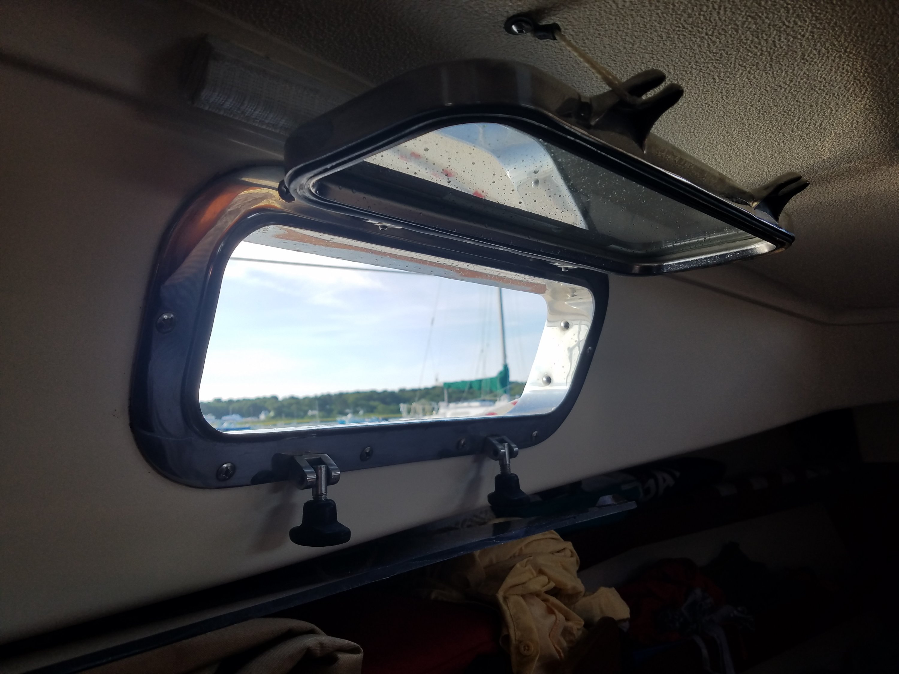

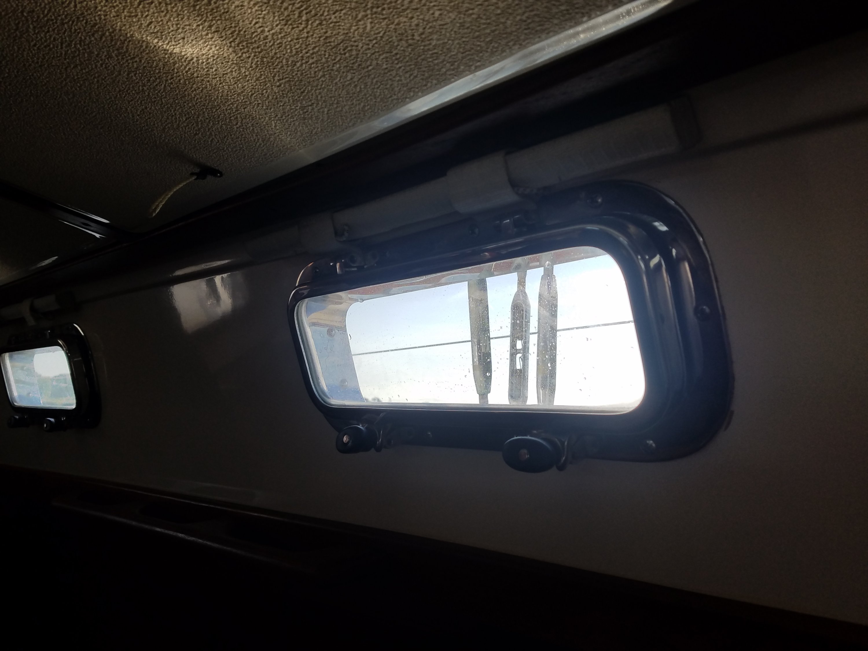

I have ten of these stainless steel portlights on the 1996 Tartan 3800. A couple are leaking, not the window gasket, but through the frame to boat joint.
It seems pretty straightforward to remove them to re-bed, but I wanted to see if I could find instructions.
I searched and found pics that look identical, but identifying them as Hood, Pompanette, and Bomar!
Maybe it's the result of industry consolidation, mergers, etc., but I don't know.
Can anyone please identify this light? Sorry for the poor quality of the pics.

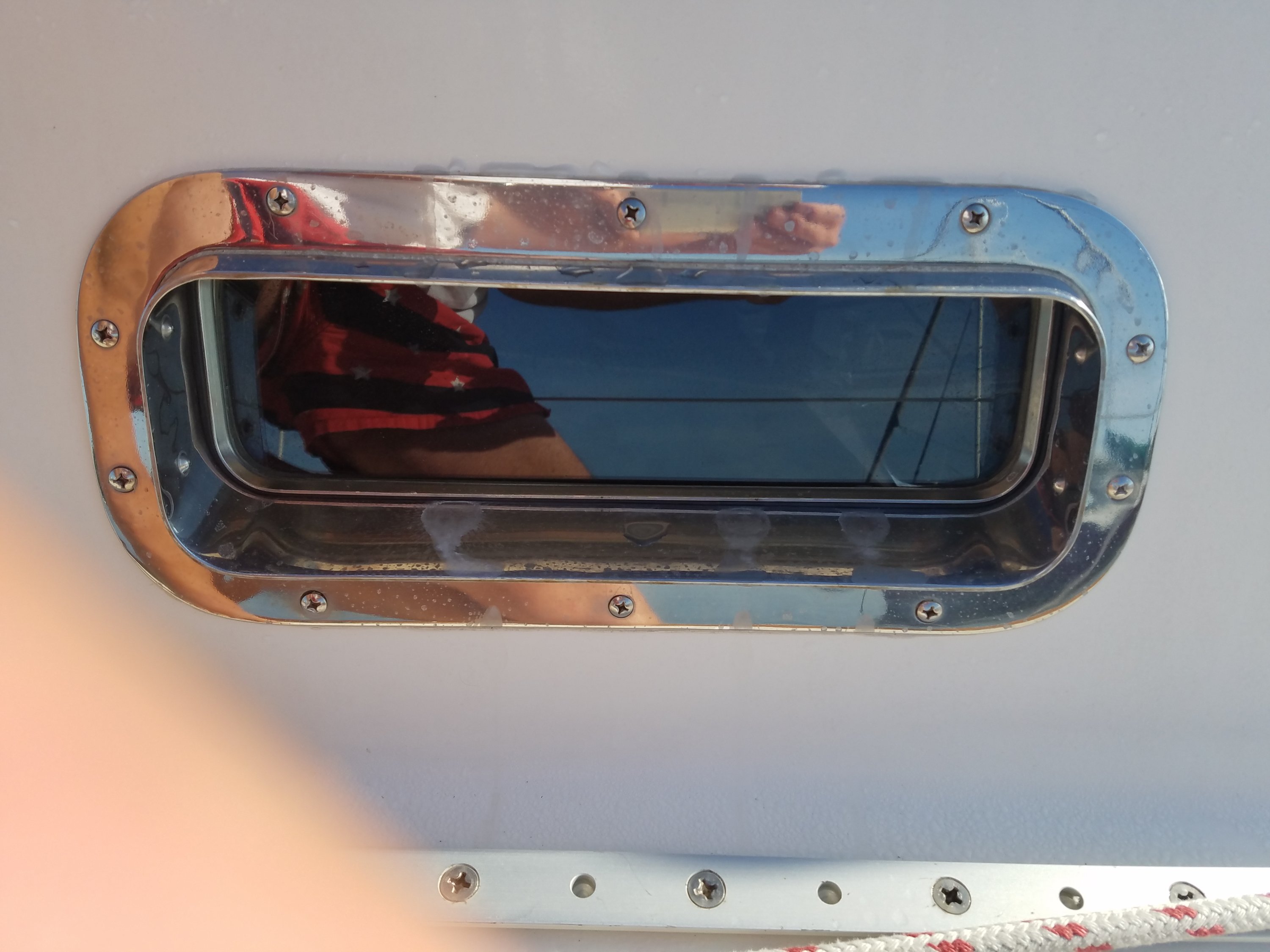

Thanks. I looked at the Pompanette Hood Passage series, which they also I.D. as Bomar, and in the text is says "no exterior visible screws." Mine have exterior (and interior) Philips oval-head screws.
Here's the outside:

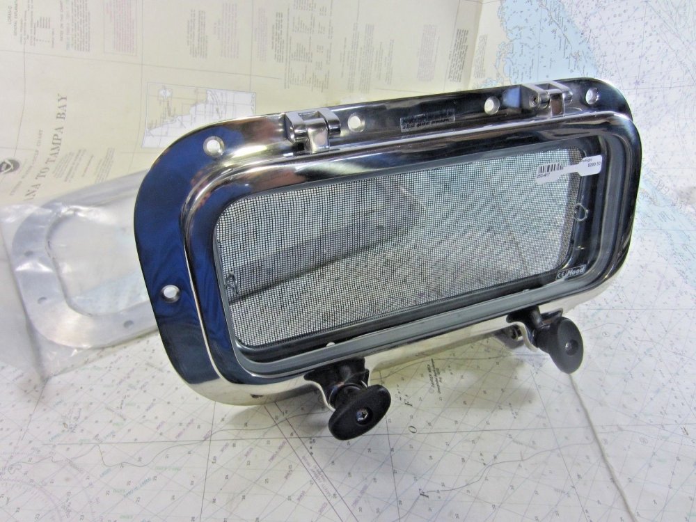

Well, aren't you in luck! I just ordered and received that exact port; Pompanette Portlight H6540-125-A 5X12X1.25 SS Rec Port w/ Screen. Notice the dogs are oval. It may not be the same dimensions, but $ to donuts it's the same port.
Likes: jviss
