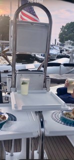

Nov 9, 2023
15
Hunter 36 Merritt Island
We had these made for all the reasons above- the originals are a PITA...in the process of varnishing them. They're just under half width
