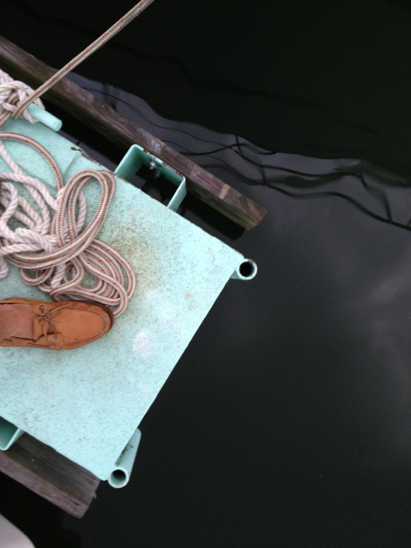

Haha. Was thinking of tying a large cylindrical fender vertically into the gap at the corner.

Docked at Coronado for lunch. The public dock is cushioned with tires. Left some nasty black marks wherever they touched the hull. I would imagine the big box home improvement stores would have some kind of vinyl edging that would work along the dock. For the corner, doubt the Marina would let me hammer or drill anything with significant holding power into their floating dock. Install a wheel and it's probably theirs when you retire to Curacao.
Yeah well, when your boat contacts the vertical fender it will roll away and expose that steel boat-opener. Take some measurements and you can frame up an assembly at home, add dock edging, and attach it with a drill and 4 bolts when you get it down to the marina. You can buy enough dock bumper to do the job for less than the cost of a fender.

We used indoor/outdoor carpeting purchased at Lowes. Tacked it into place with small flathead nails. Use galvanized if you can to prevent them from rusting. It's a cheap fix that works well and helps avoid those ugly black lateral streaks on the hull.

If want to go real cheap... Floater foam for swimmers.. Comes in tubes (noodle) and flats.

There are bumpers made to put on fender boards. Maybe one size will fit over that board, but don't know the size of the board.
