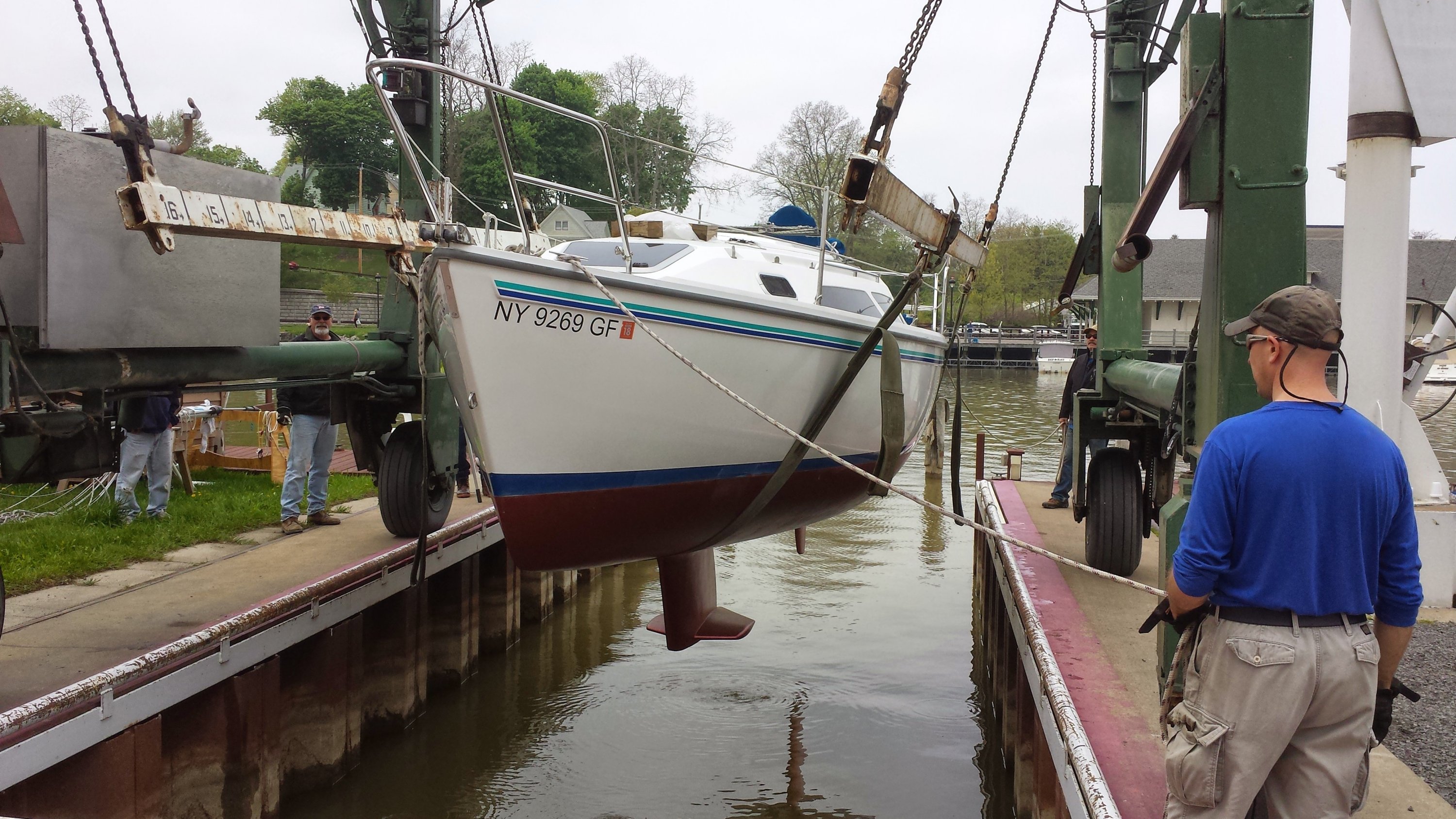

Oh...ok. You would have to have a ramp setup for a travel lift anyway.
Ramp is easy to build with pilings. But having a travel lift is the issue for most "clubs" as the club is not a marina, that is, member ran and not a full time job with volunteer labor.
That said, last year a A-1 working lift sold for pennies at an auction. Why no working MARINA on Lake Murray bought it, I do not know. There is NO LIFT on the lake, that is Lake Murray.
