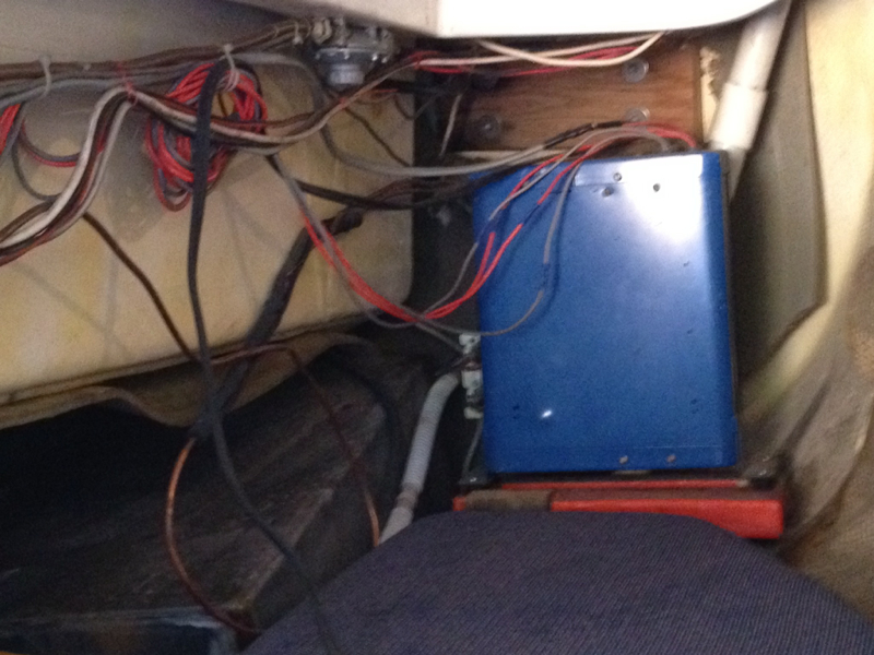

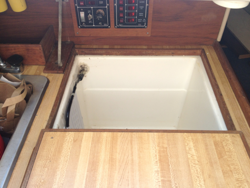

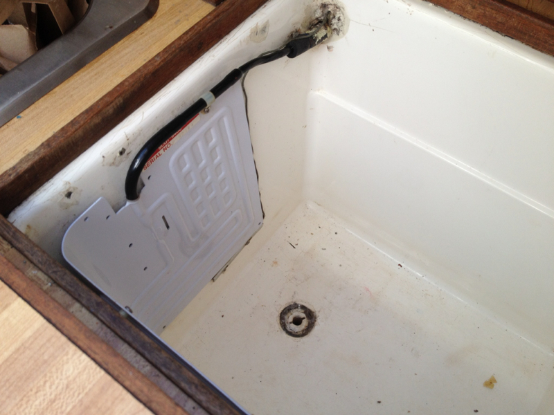

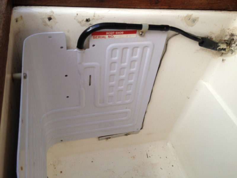

Upon looking again, I'm thinking there may have been some modification done. There is a cooling coil inside the "ice box" that seems to be attached to some sort of electrical...thing. I'm attaching a couple pics so people can see. It plugs in to an electrical outlet and when I do so, I hear a very small click, but that's it. Does anyone know about this? Please see attached pics.

Yeah, someone tried to convert the original icebox by installing a freezer strip. They are expensive, and if the freon or ammonia or whateverthehell was in the thing for refrigerant leaked out, which they do, it's toast. It's a cool idea, pardon the pun, and I'd do it myself if it wasn't so expensive. Actually, looking at the second pic, someone went the cheap route and gutted a cube refridge and took out the little freezer unit at the top. Whoever did it was a gadget guy and had to be careful not to nick the line anywhere when removing. Underneath looks like an inverter.
