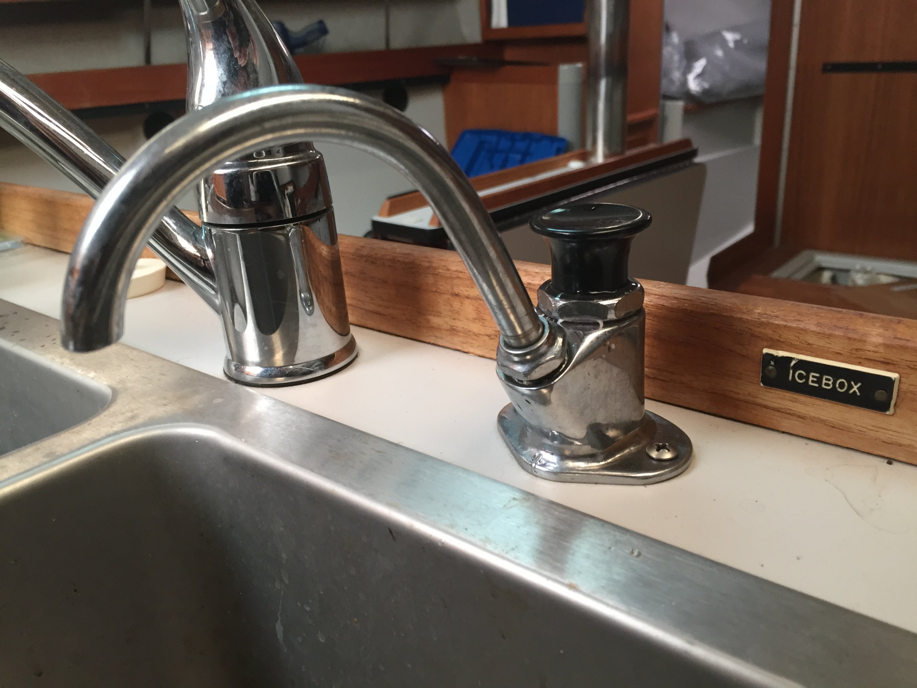

Same on the O'Day 272 LE....only ours never worked from the beginning so we purchased a repair kit and it still did not work so we purchased a small electric water pump to pump the icebox water to the sink where it goes overboard, not into the bilge....in fact the elec. ice box pump saved us last week when our AC water pump cracked open filled the starboard

On our Cat 310 the fridge drain is hooked to the shower sump pump with a "Y" valve. We just switch the valve and turn on the pump, work great when cleaning the unit as we don't have to worry about how much water is used.

Interesting read. I was always wondering where the icebox drain went. It always backs up. I don't have a fynspray pump. I wonder if indeed it's connected to the shower sump or bilge
