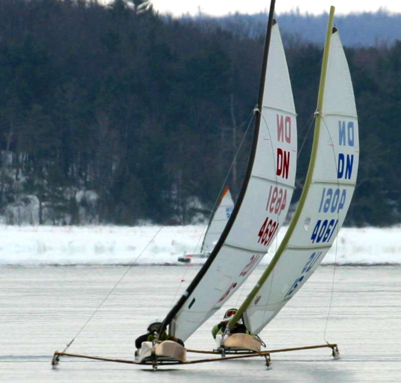

An iceboat sails with the apparent wind always in front of the beam, both upwind and downwind. Control wise, boats like the DN only have main sheets, which also act as Vang and back stay.
The mast is very bendy to allow the top to twist off. Trim to keep the boat on two runners. The sail has both luff and leech telltails, but mostly keep the boat fast and flat. That will give max VMG.

On one hand, I wish it was warmer here. On the other hand, that looks that like more fun than....
My tri is too slow.

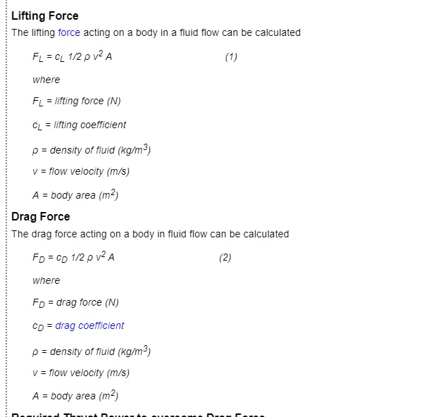

Some interesting things about ice or land sailing from looking at the equations for lift and drag.
FYI, the equations come from here https://www.engineeringtoolbox.com/lift-drag-fluid-flow-d_1657.html
I copied the basic lift and drag equations from that web site in the image at the bottom of this post and want to note that the force equations for both lift and drag have V**2 (ie, velocity squared) in the equation. Compare what that does for a sailboat doing 6 kn in a 10 kn wind and an ice boat doing 40 kn in the same 10 kn wind (both sailing perpendicular to the actual wind direction).
The apparent wind for the sailboat for the conditions above would be 11.66 kn. The apparent wind for the ice boat would be 41.23 kn.
That wind speed term gets squared in the lift and drag equations and if you compare the squared apparent wind speed multiplier, that multiplier is a huge factor of 12.5 times higher for the ice boat even though the actual wind speed is the same.
For lift force, it cant be too high or it would tip either the ice boat or the sailboat over. Lets assume the same lift force between the two craft in this example (not that far off - remember it cant push the craft over). What has to happen with the ice boat is that the term CL (coefficient of lift) needs to be a factor or 12.5 times smaller. CL is proportional to the sail angle of attack so in general a very fast craft will operate at a much lower sail angle of attack compared to a slow craft.
Next thing to note is that the drag of the sail becomes much more important for the fast craft since the drag force term also is proportional to the square of wind velocity. Ice and land craft often have different looking sails (high aspect, wing mast for example) and part of that is keep the drag low at the high velocities that are attained.
The other interesting thing regards the wind height gradient which is part of the reason for sail twist. If the wind is 6 kn at 2m and 10 kn at 10m, for the sailboat going 6 knots, the difference in apparent wind at the two heights is 8.49 kn and 11.66 kn or a 37 percent difference in apparent wind speed with height. But for the ice boat doing 40 kn, the apparent wind speeds over height is 40.45 kn and 41.23 kn and only a difference of 1.9 percent.
So for the ice boat, the issue of wind speed height gradient pretty much goes away.
