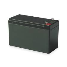

I want to charge a 12v battery with a 12v battery so I can have 12v
Sep 24, 2018
3,994
Catalina 30 MKIII Chicago
I use a trolling motor on my dinghy because it's fun. I typically use a small 7 amp gel cell because its very portable. It's enough for 1-3 days. I'd like to charge it off of my car. Would a solar charge controller work for this purpose? I'm not looking for anything fancy since these batteries only cost $10-15

I want to use my car to charge my gel cell so it's ready to go the next day. I originally bought the gel cell for a UPS but havent gotten around to installing it. There was no charger included. Running an inverter to go from 12v to 120v to 12~16v seems like a very round about way of getting 12v not to mention it would probably kill my battery if left on overnight.
Even if the gel cell was totally dead, I doubt charging it back up would drain more than 15% of my car's battery. Not enough to put me in a bind in the morning.
So, with that said, I'm really just looking for a way to keep the gel cells from overcharging. I've seen those things go up in smoke a few times

At the moment I've been pretty nomadic. I've only spent 2-3 hours at home this week. The only thing stopping me from directly wiring it up to my car's electrical system is the fact that it would be overcharged. Most days I don't discharge them less than 40%. If they don't get to 100% it's not a big deal. The marina isn't big and I'm perfectly capable of rowing. It's basically a toy to keep me happy while at the marina. I figured a cheap Chinese solar controller would be sufficient to charge these little batteries. Any suggestion on rating? 20 and 30A seem fairly common
