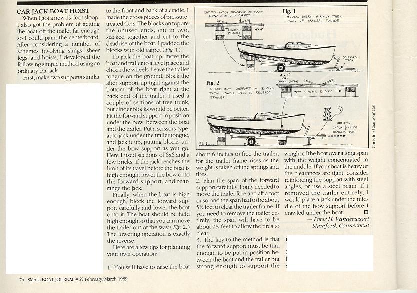

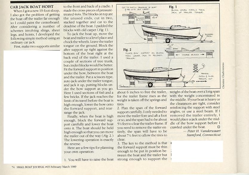

Commonly done on boats this size is to erect supports at either end of boat, tilting trailer both up and down at nose to get boat supported above trailer, slide trailer out from under boat, drop centerboard. Reverse process when boat/centerboard is ready.
Fred W
Stuart (ODay) Mariner 19
Jun 2, 2004
1,955
Oday Day Sailer Wareham, MA
Here is the way that appears to have been used by the owner of a Rhodes 19, I use a similar idea to move my DSII part way off the trailer to paint under supports and the Centerboard trunk and most of the centerboard. I use the tongue jack for most of the lifting of the bow.
