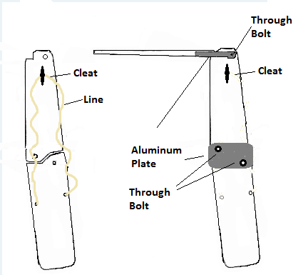

I've made a rudder (and tiller). It is not hard and won't cost you that much. I've attached some pics and drawings that should give you and idea of how to do it.
Wood for the rudder stock should ideally be some decent hardwood, however even if you used a cheap piece of 2" X 12" stock pine (joist) and kept the rudder well varnished your rudder would last your 10 years or more and cost you less than $50 to make. You can get everything you need at Lowes. Your boats spends most of its life on a trailer so your rudder won't actually be in the water that much. Put a coat of varnish on each season and it will last a good long time.

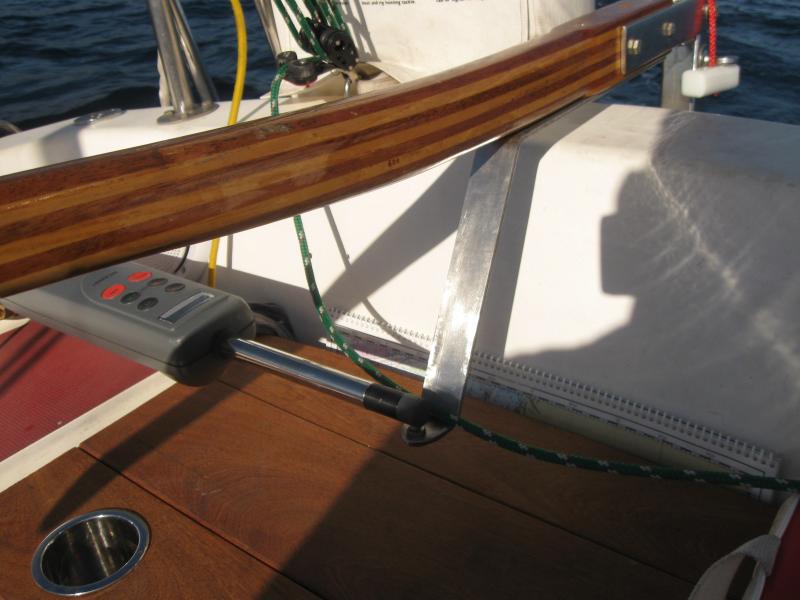

I think the single best improvement I made to my v222 was the idasail rudder. I modified it with a couple of eyebolts for my mast crutch and a bracket for the tillerpilot.

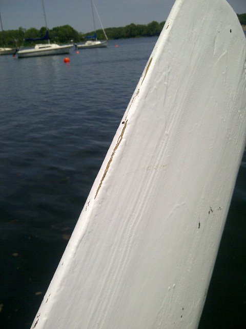

I reshaped my rudder. A PO had the idea that if you just rounded the edges of a (oak?) 2x12 that was a good enough foil shape. I used the same piece of wood and a belt sander to get it to approx. 0018 foil shape. Then covered it with fiberglass mat and painted with interlux. It cracked along the back after it was in the water for all of 15 min! I think the wood swelled. Oh well, I'm not concerned as it is a temporary fix until I can have one made of aluminum. (Search rudder vs pencil)
Here is a link to a foil shape web page. Airfoil Investigation Database - Welcome
Pictures are: 1 Old rudder on boat. 2 crack in trailing edge of newly modified rudder.
