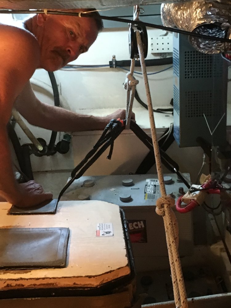

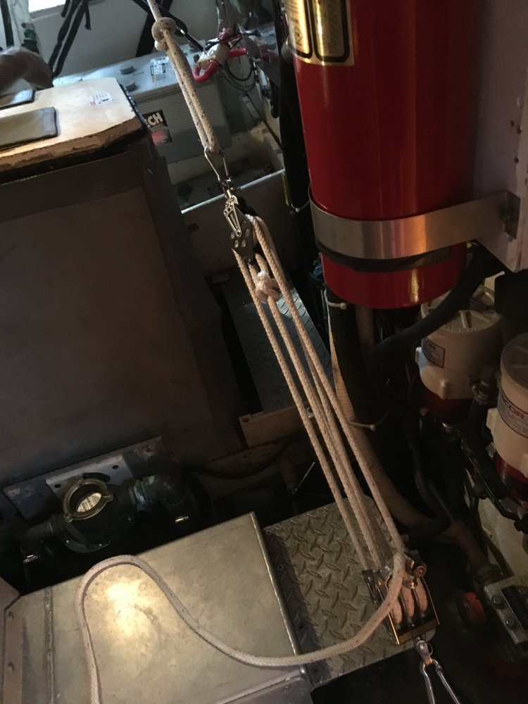

With the bow eye secured to the cockpit locker we were able to run a 5:1 through the engine room to the batteries. Once we got them up we replaced the dyneema loop for a bowline and muscled them out of the way

Amazing. Those boxes (do you have 3?) look identical to ours which are obviously smaller as they hold 4d's perfectly. The diamond plate floor is a nice touch.
Oct 2, 2008
3,811
Pearson/ 530 Strafford, NH
That’s part of a cover for power take off on the front of the engine that runs the hydraulic bow thruster.
