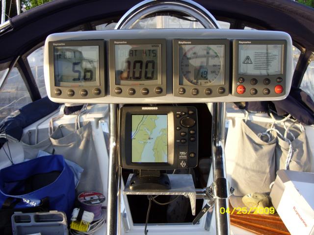

Humminbird 785C2
Really like mine. It has the external GPS and works well. Their customer service is awesome (this is the 2nd Humminbird product I have owned; left the old fishfinder on the old boat but it is still going strong after 8 years.) It uses the Navionics charts which are kind of substandard for the price, but the display is one of the biggest color ones around.
My only regret (minor one) is I did not get the upgraded unit with the integrated fish finder.

Here is a picture
The Chartplotter does talk to my Standard Horizon VHF for DSC and to my Raymarine S1 Autopilot through NMEA, but there is no interface to the SeaTalk instruments like the ST60 wind, depth or speed log.
One option would be to look for an NMEA 2000 unit. I have no experience with them.

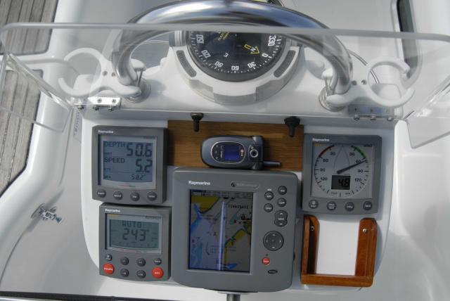

Stick with one brand and things are simple
I bought a Raymarine RC 435 to make sure all the data from my Raymarine ST60 instruments and Raymarine autopilot would work together. They do and I love the 435. I was particularly happy went I chartered a boat from the Moorings in the BVI and stepped aboard to see a 435. I knew how to use all of its features without any instruction.

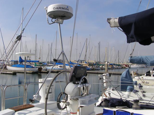

Buy Garmin's 3210 with gps and you can tie-in a radar, depth, etc. Cost is ~$1000. Google it and you should find low price. I purchased and installed one from West Marine last December. I like the large screen. It also has a split screen for radar and chartplotter.
