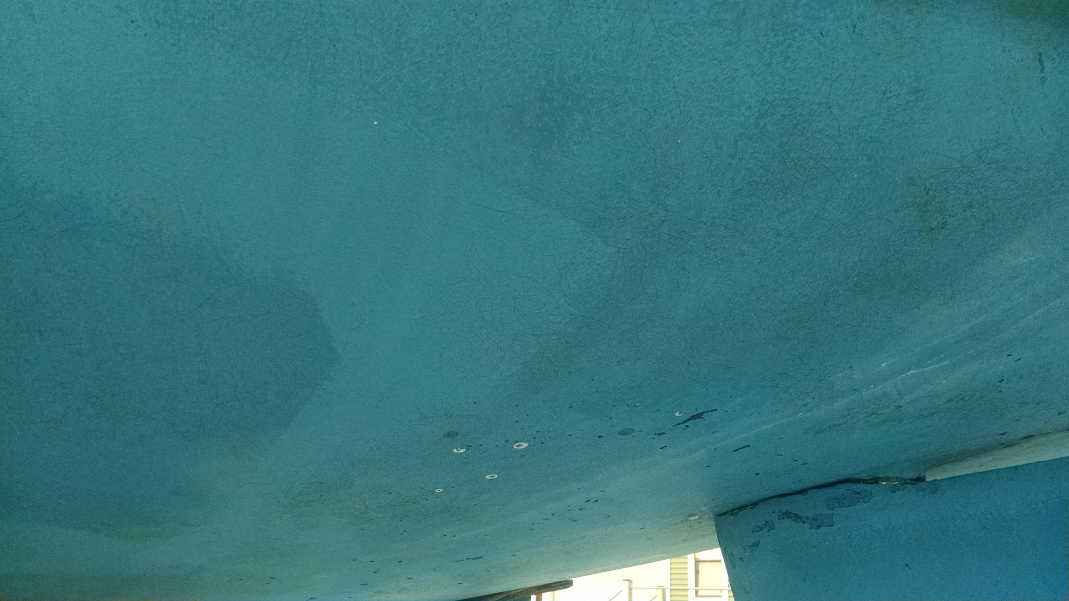

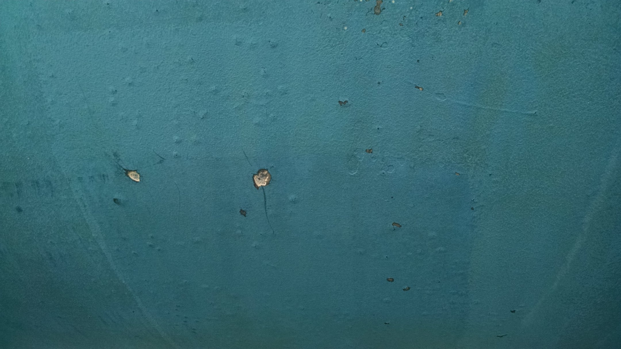

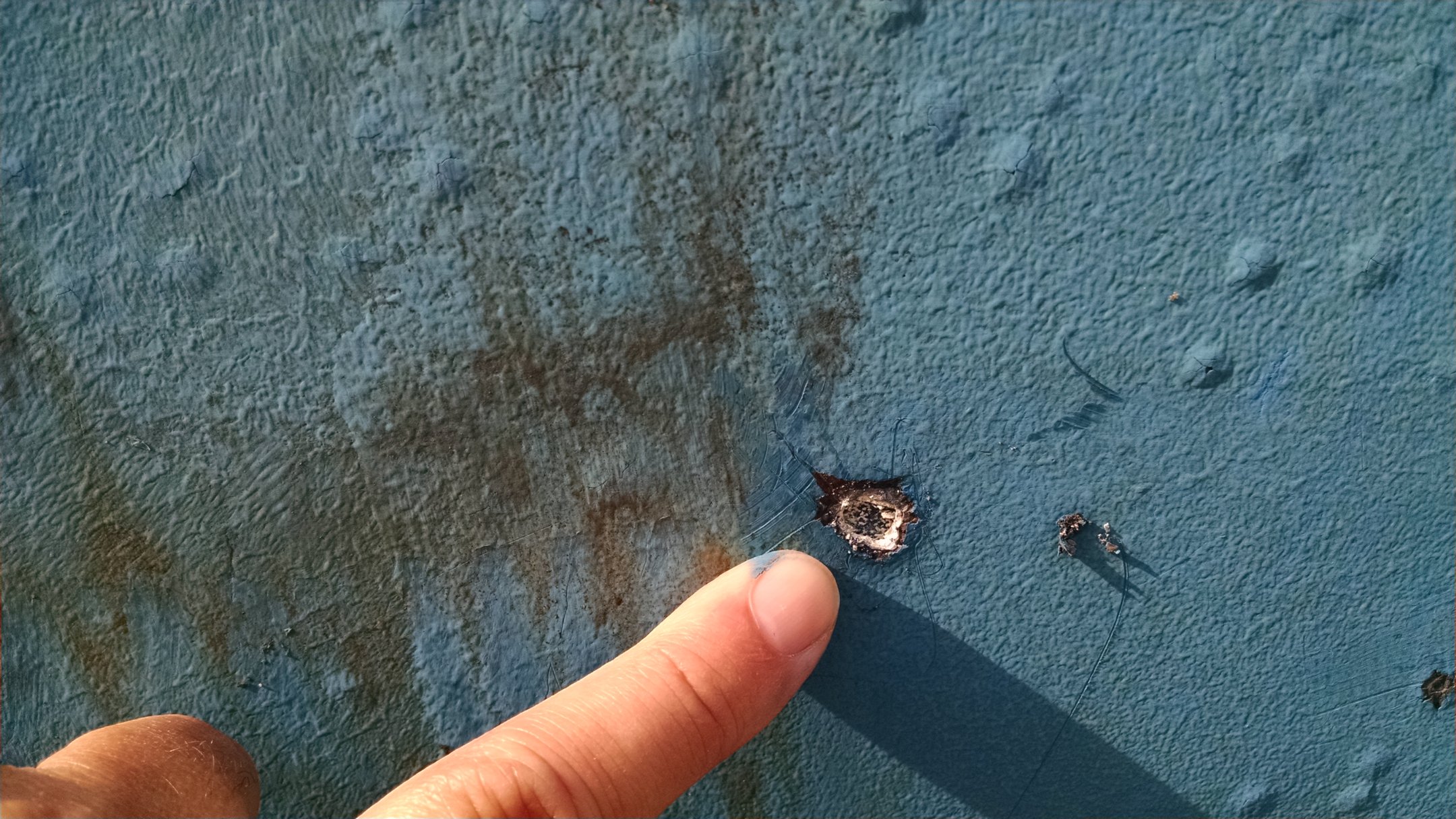

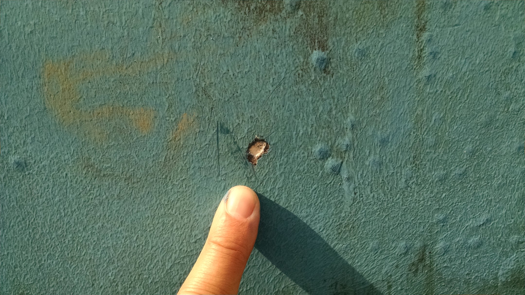

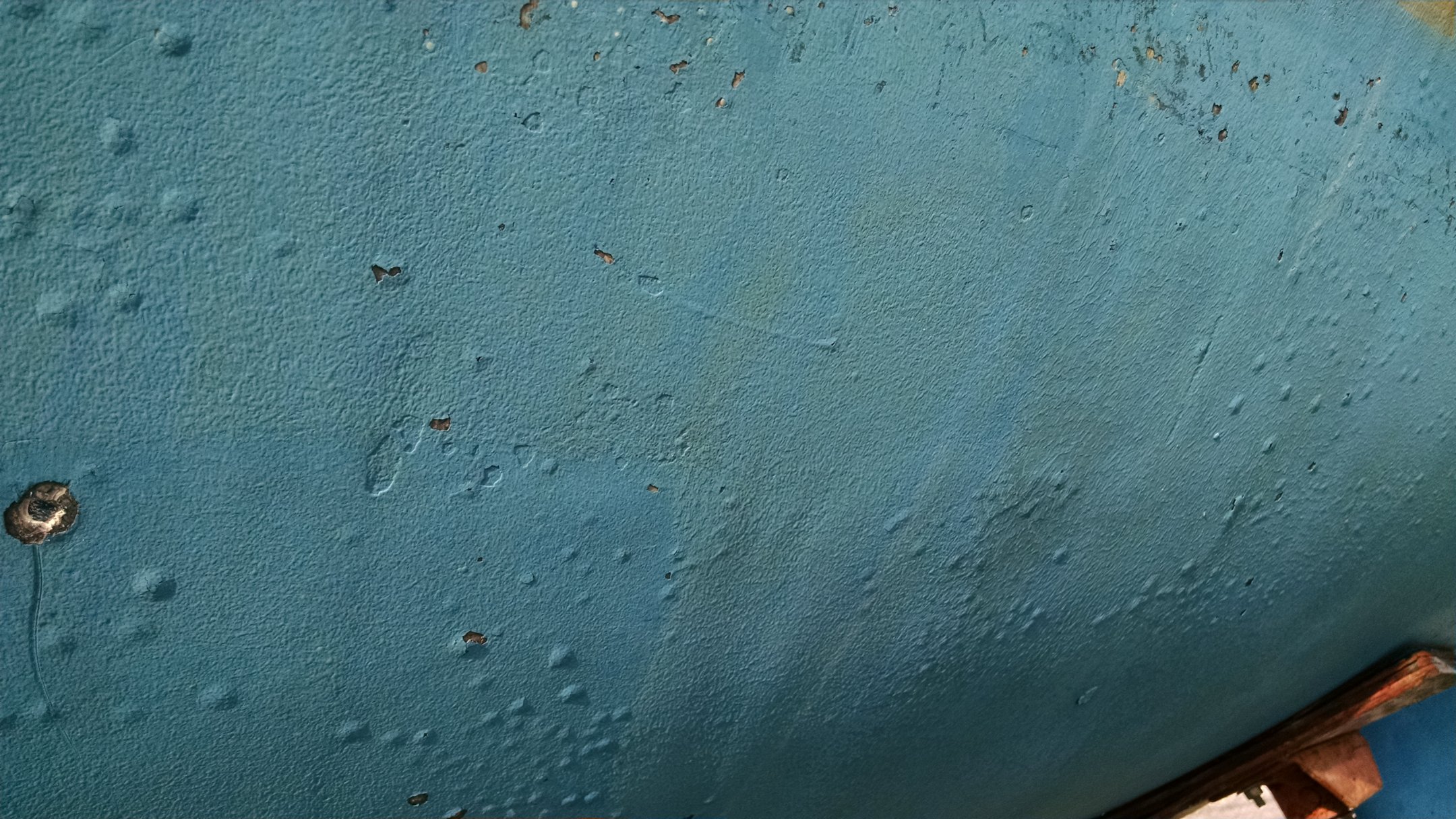

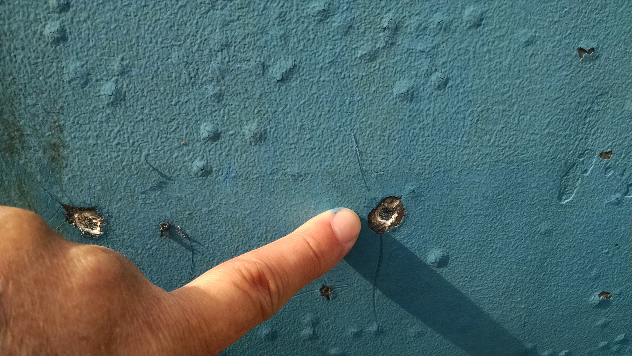

I visited the boat again on Saturday and looked at the hull. All Blisters or "pox" are now invisible. I attached 2 pictures below. The only evidence of this issue are the three blisters that the yard guy dug out the day it was pulled. Armed with the knowledge I gained from this thread I told him what I wanted done. I told him I wanted to soda blast the hull and asked him for a competitive quote. He told me he does not soda blast nor does he allow outside contractors to as he says it is too messy. Fine. I have all winter to figure this out. If I can't come to terms with this yard I will simply pass on all services, do spot repairs on the open blisters in the spring, splash, enjoy my summer and fall and haul again for the winter at another boatyard that is more flexible and get the work done then. I have a contract for winter storage with these folks. I needed to pull the boat this winter as it spent the last 2 years in the water so the money spent so far was not wasted. It is a nice secure yard to store the boat.
