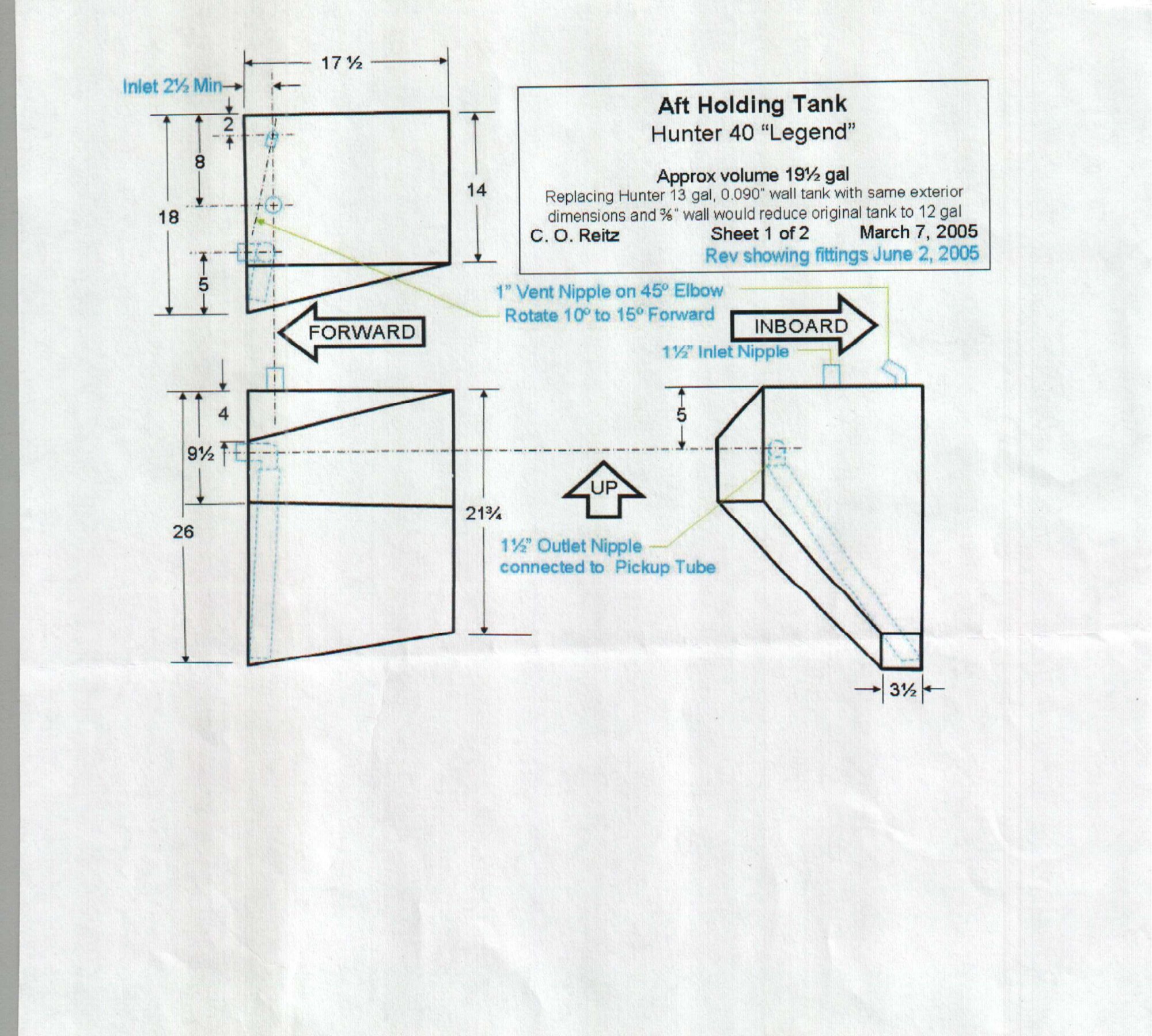

On our 1989 Legend 40 the holding tank is in the aft cabin which you may want to consider doing.
We replaced the aluminum tank with a plastic tank from Ronco Plastics which has the pattern for the custom tank on file.
