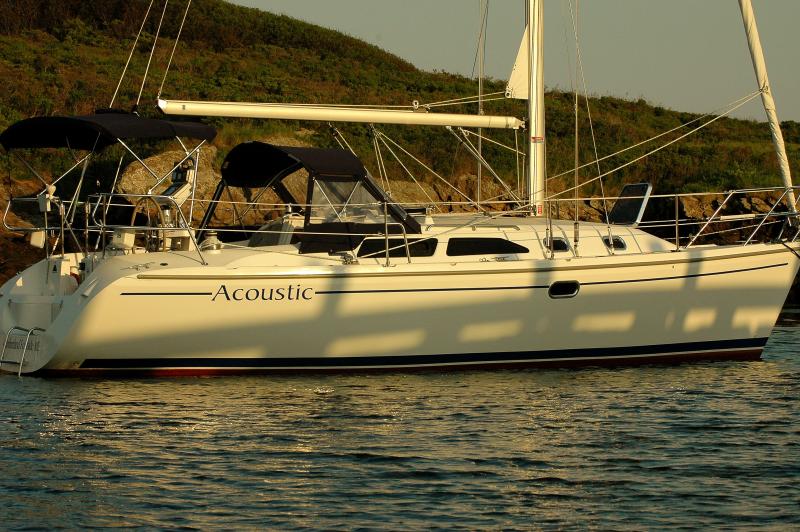

If you have the double Catalina cove stripes (usually blue & silver) you might opt for one slightly wider single blue stripe. I did this on my 310 and it made her just a little different from all the others and a little more perhaps a little more classic. If I could have only gotten rid of that ugly looking hull port she would have really stood out...:doh::doh::doh::doh:
If you want to practice with positioning and tape widths you can use 3M long mask blue masking tape. It costs nest to nothing, at Wal*Mart, but will let you experiment for the best location and widths based on your free board for your particular boat..
Single cove stripe..

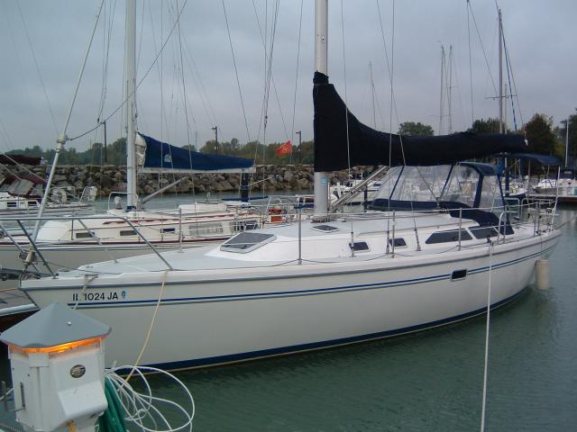

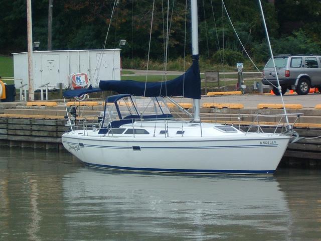

My 95 had a turquoise & blue cove stripe that I hated. Catalina used this color scheme for a few years during that era. The real work was in removing the old striping. One of the colors came off more easiliy than the other for whatever reason.
The cost of the new stripes was really reasonably from Catalina. I don't think I paid more than $100 (3 years ago). I just centered them with the hull ports. The two colors came on the same sheet also so the spacing was no problem. I was happy with the job especially for the money. Labor provided by crew.
