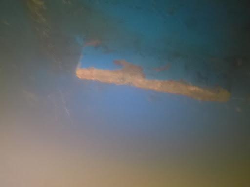

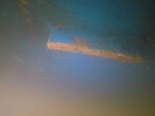

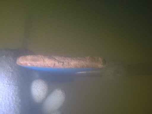

It was painted. About a year and a half ago I had the local yard (KKMI) install a new cutlass bearing, so it at least held up through that. Our diver did indicate that another boat on the same row as us lost their strut recently. I asked him about it being a hot harbor and he didn't seem to think it was hotter than usual. Alternatively, after thinking about other possibilities, we did bump a deadhead last year, it's possible it hit the strut before popping up the back and just took this long to manifest.
I attached some pictures provided by the diver.

It looks just like ours did. After ours broke, another skipper down the dock with the same make and model said same happened to his a year earlier.

It looks like a fracture from a hit..... Struts should never be painted with a copper based paint because the copper will leach the zinc from the bronze - if the bronze looks pinkish, that's what's happening. I lost my strut because of dealer incompetence; the boat was delivered with a strut that was cracked completely around and the dealer painted completely over it. He also used the wrong color paint (blue) and since that original coat Escape has always had black bottom paint. When the strut broke, there was blue paint inside the break! My shaft wasn't bent so the replacement was fairly straightforward.

From what I've seen, these struts don't look like they are made from bronze, but rather more likely a leaded yellow brass casting alloy. It's hard to really say what the alloy is unless I were to spend quite a few $'s to have a complete wet chemistry performed on a strut to get the specific chemistry identified. This family of brasses is frequently used in plumbing fixtures so there is a "logical support" in the original selection. They are typically less expensive to cast than the navel bronzes. They are also not particularly strong tensile strength wise.
Most of the bronzes have a more significant amount of tin in them than zinc, but the bronzes really are all over the place as far as chemistry. The general rule that brasses are copper-zinc and bronzes are copper-tin alloys is a gross generalization, but is generally indicative...
It's kind of hard to complain about a strut that runs for a few decades and then fails... At least hard to complain in any formal way - e.g. legal action.
The photos taken by your diver are remarkably well done for underwater photography. I'd guess your strut broke in fatigue in a back and forth bending motion due to the action of your propeller, likely happening over a significant amount of time - e.g. - the life of your boat. The surface cracks that would have developed over time would have been nearly invisible under visual inspection. You would probably have to go to a dye penetrant type inspection and I don't think most folk would even think to worry about that on a strut that has been doing just fine for a number of years. Also, if you bottom paint over it, you won't see them.
There are no visual indications, that I can see in the limited information you have there, that there is anything wrong with your harbor being "hot".
