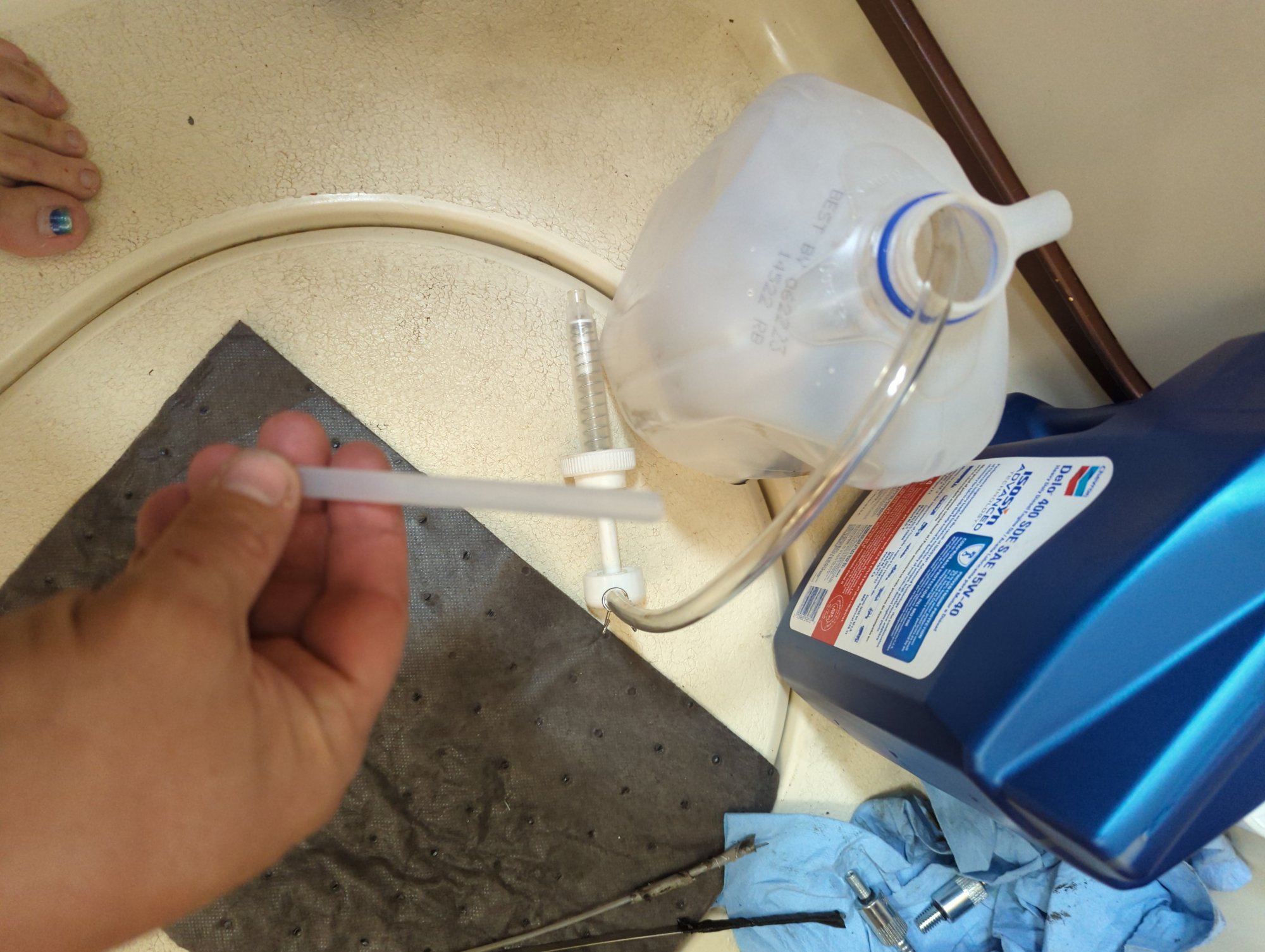

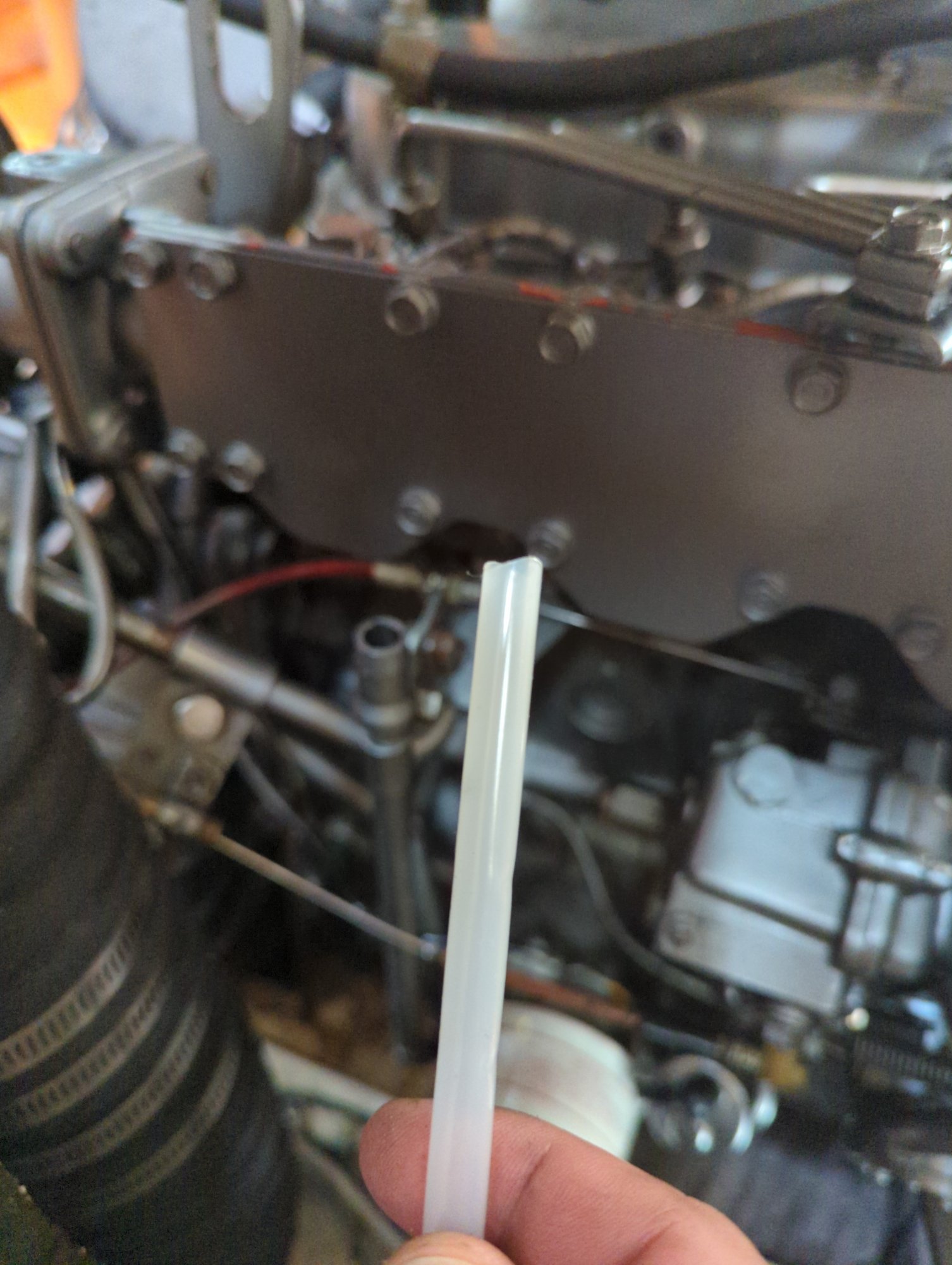

I was attempting my first oil change on my 93 Hunter 40.5 which has a yanmar 4jh2e the pump I was using is s***** and I am a dumbass and the 4 inch plastic tube for pumping the oil out fell down the dipstick tube.
Initial attempts to fish the tube out with electrical tape on the end of the dipstick are unsuccessful.
Is there a way to remove the dipstick tube? What are my options besides pulling the engine to remove the oil pan to retrieve this stupid piece of plastic?

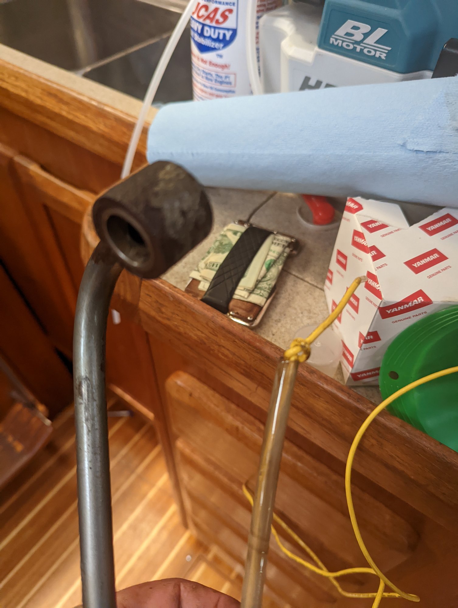

Problem solved.
Thanks all! The dipstick is in fact removable and small gauge wire with a knot tied in the end pulled through from one end to the other got that silly tube out the engine is back together and running smooth.
