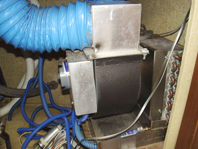

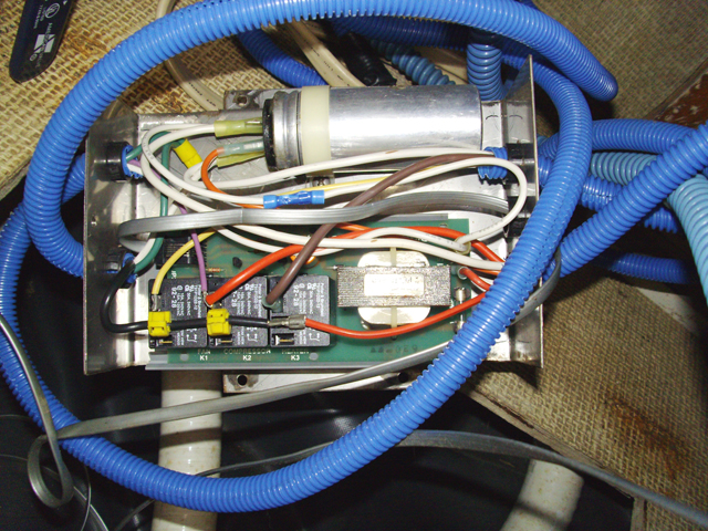

This weekend the compressor in the aft cabin quit coming on. The fan runs and the relays that trip the water pump and compressor closes, causing raw water to be pumped. However, the compressor does nothing. I opened up a metalic box that holds the circuit board and that contains 3 relays. The relays control the heating strip as well as the raw water pump and compressor. The starting capacitor, which has 4 connectors (3 of which have wires attached), is also mounted beside the circuit board in the metal box.
I shorted out the leads on the relay associated with the compressor to see if I could get the compressor to work while the raw-water pump was pumping. No sparks or anything which could indicate that the relay is good and that I should be looking else where for the problem.
