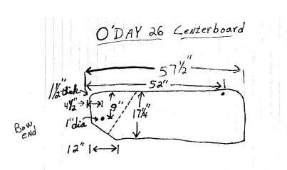

I am looking to get dimensions/weight etc. for a Centerboard off a 25ft Oday
I lost my keel in the tampa Bay and want to make a new one instead of buying a pricey replacement. Does anyone have the exact dimensions/weight, etc. for a keel from a 25ft 1982 o'day?

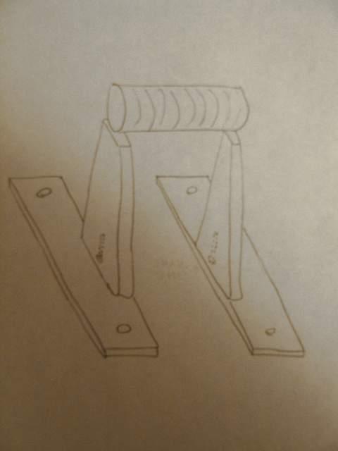

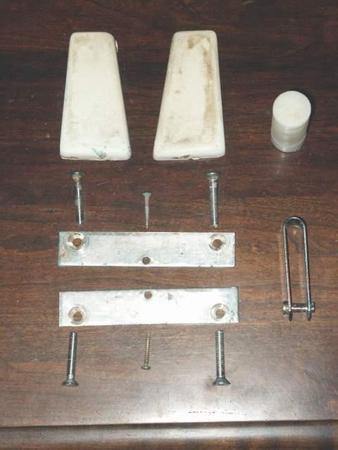

Actually, I think you need the details on the centerboard and here is a sketch of the O'DAY 25/26 centerboard. Weight is not much, maybe 40# (+/-). It only need to be heavy enough to not float and so it will pivot down on it's own. O'DAY put about 15# of lead flashing inside the hollow CB to accomplish that. I've also included a picture of the parts that make up the assembly that holds the CB pivot pin into the keel and a drawing that shows that all assembled. The details are actually from a 222 (TRINKA), but O'DAY used the same basic parts for the 25 (check with D&R Marine if you want to be sure, Rudy has good info even if you make your own CB).
